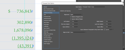

Or you could use two different ParaStyles - one for texts with ")" and another without - then align them right - but with extra inset.
Underlined is a 2nd ParaStyle.
I've used a different font so your values would be different.

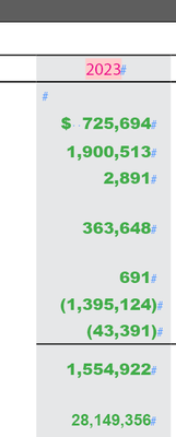

Does this work? This is a copy of the exact file I'm using

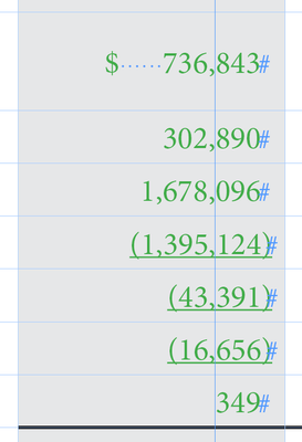

Looks like the problem is with the fact - that you have your text RIGHT aligned.
After switching to LEFT - it works - as long as there is only ONE ",":
So, you need to change format of your numbers.

Or, a slight modification to what @Willi Adelberger suggested - add "hair space" at the "point of alignment":
In your case it would be after the numbers - before the ")".

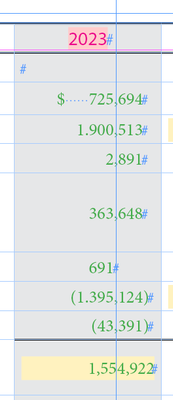

LEGEND ,
Dec 16, 2024 Dec 16, 2024
@tabitha_6060

Ahh, that makes sense. I had to adjust a few other things, but that worked! Thank you so much for your help 🙂
