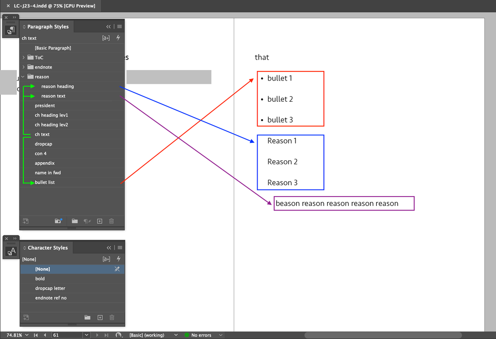

There are bullets (Screenshot 1).
There is some text (Screenshot 2).
Both share Left Indent: 1p10.
On Id, they are aligned (Screenshot 3).
On EPUB, they are not (Screenshot 4).
Is there any way to align them on EPUB?

As seen in Screenshot below, three paragraph styles are based on ch text.
Hosun

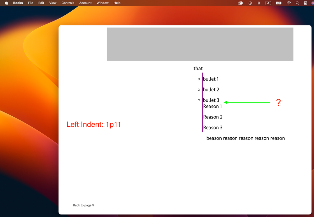

Enthusiast ,

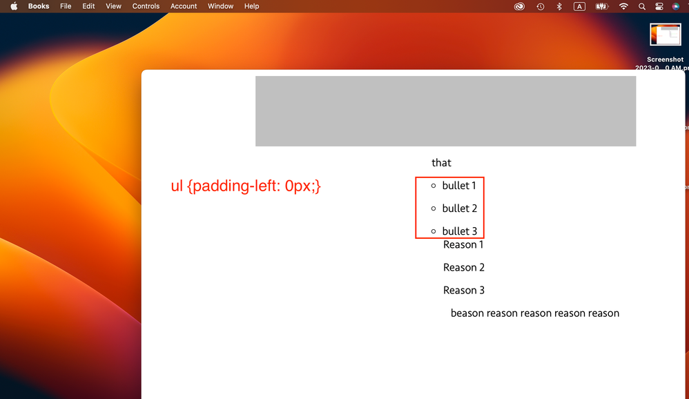

Feb 19, 2023 Feb 19, 2023
Screenshot 1.
I applied ul{padding-left: 16px;} to Bullets.
Screenshot 2.
I tried to align Reasons to Bullets.
When I increased Left Indent by 1 point, there is a big change to Reasons and space disappeared between Bullet 3 and Reason 1. It's OK in the text (Screenshot 3).
Are there more issues for me to resolve?
Hosun
Screenshot 1Screenshot 1Screenshot 2Screenshot 2Screenshot 3Screenshot 3

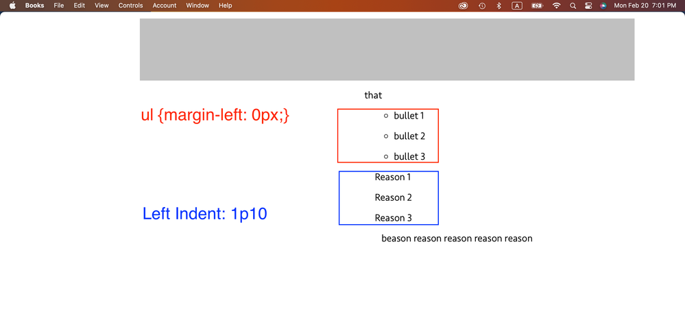

Enthusiast ,
Feb 20, 2023 Feb 20, 2023
I appiled ul{margin-left: 0px;}.
It doesn't work.
To my view, padding-left looks like working as margin-left on Books app.
Hosun

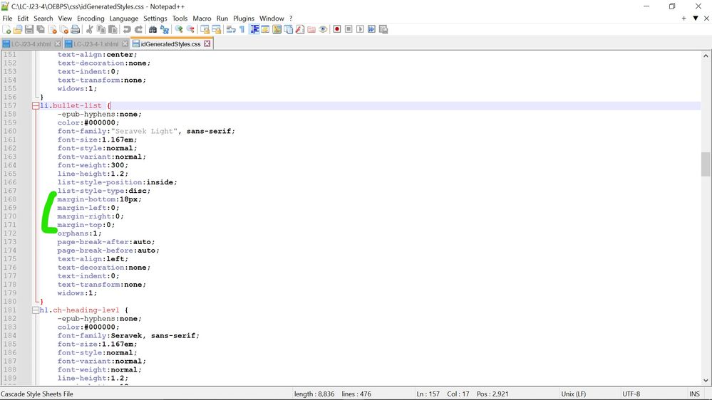

ul {
margin: 0;
padding: 0;
...and experiment from there.

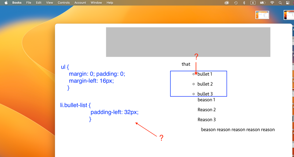

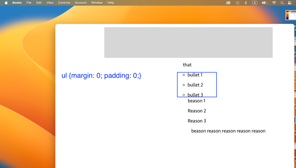

[Screenshot 1]
ul{margin: 0; padding: 0;}
[Screenshot 2]
ul {margin-left: 16px;}
margin is working.
[Screenshot 3]
To give a space between the bullet and the text, I applied
li.bullet-list {padding-left: 32px;}
It is not working.
Q1.
From your remarks, I should set margin in li.bullet-list. I have no idea about how to do in [Screenshot 4].
Q2.
What's the difference? (with and without px)
ul{margin: 0px; padding: 0px;}

Feb 21, 2023 Feb 21, 2023
Once again, this is a complex area of EPUB setup and there are several factors that work together (and sometimes against each other) in aligning bullet lists, especially relative to other text.
To sum up, though:
  • Defining <ol>/<ul > in the CSS both overrides some wonky defaults from InDesign and is best used to "zero out" the frame or "div" for lists so that other settings make more sense. At zero, list items should sit against the left margin of the reader... which may not be the left margin of the screen.
  • The left margin for <li> sets the spacing between the margin and the bullet or number.
  • The left padding for <li> sets the text indent from the bullet or number.
...and that's in "most cases." There are times that either EPUB or the Kindle Previewer decides to interpret things a little differently, although I have found that this is usually a glitch, not the regular or proper way ID should be exporting the code. It helps to occasionally close InDesign (and the document) and ropen it, then export to see if you get a different result. Some complex documents and CSS files will only export correctly once, and then start getting odd little glitches on repeated exports... I don't know why and it's not readily repeatable. So try that close-and-restart when all the numbers in the CSS defnitions aren't doing what you expect.
Enthusiast ,
I'd rather go with Screenshot 2.
Thank you very much for your help.
