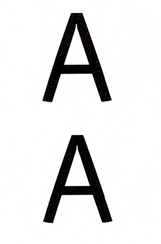

Hi! I'm wondering if anyone can help with what I imagine is a "settings" type issue.
I am trying to print really basic stuff. Like, basic fonts and vector images in black and white.
When I try to print from Illustrator and InDesign, the images and text appear as tiny printed black dots (or, with thicker type, just super jagged edges). Like, it prints like a crappy rendering of the fonts and images.
Zooming in on the computer screen, it's all crisp, even when something the size of a 12-pt period, zoomed in to the size of my head. So, I do know what a vector is and that it's not a poor resultion image that can't be blown up.
The same fonts print beautifully from Microsoft Word, etc.
I'm attaching an image of a photo of a couple sentences that I printed in black and white (sorry I have whack lighting; it's just black toner on white paper). The sentences on the computer screen look normal.
I'm using a super basic printer--a Brother black and white laser printer (MFC-L2750DW).
Does anyone have ideas, or is there any additional information I need to research about my settings or printer? Extra extra gratitude to anyone who can answer like you're dealing with a total newbie.
Thank you all so much in advance!

I just realized that one thing that might also be helpful is a thinner type than Futura to demonstrate what's happening, in case it's more clear. Attaching another photo of Times New Roman printed, which looks much worse (I'm sure the thickness of Futura somewhat lessens the issue). Thanks for all of your help with this!!

The Adobe applications are color managed and the "jagged" edges are actually halftone (not printer) dots caused by a color conversion somewhere—that’s the reason for the appearance of black preference, which only affects black CMYK fills.

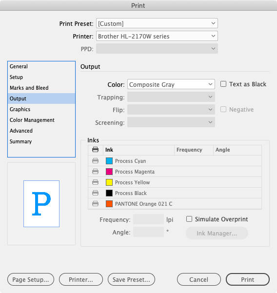

From InDesign try making a new document with the Intent set to Print, choose Edit>Assign Profiles... and set the CMYK profile to Photoshop 5 Default CMYK. Set some text filled with the default [Black] swatch at 100%, and print to Composite Gray
This is what I get from my Brother:

Found it!
Under Print > Advanced > Uncheck Print as bitmap. It did it for me!

Wow, that made huge difference for me. Thanks!! Still searching for a solution when you want to print text and a photo on the same page - I cannot uncheck the Print as bitmap in this case since this fixes the jagged text issue bit it damages the quality of the photo and I am out of ideas
