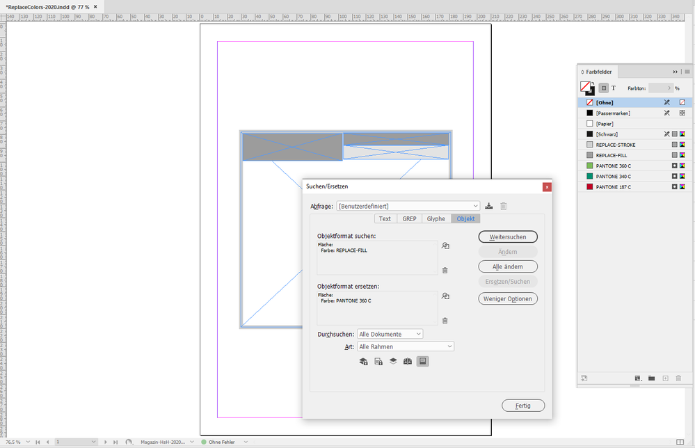

Apr 12, 2021 Apr 12, 2021
All tests done with InDesign 2020 on Windows 10.
Did some parameters in Object Find/Change in the GUI like that:
In that situation I would expect that the script:
app.findObjectPreferences.fillColor
will return something reasonable. But this is not the case. An error was returned.
Error number is 30615, error message from my German InDesign is "Diese Eigenschaft ist im aktuellen Status nicht zutreffend." ( $ID/kScriptErrNotApplicable )
Will test this in other versions of InDesign. This functionality seems to be broken for ExtendScript. In the GUI everything is working as expected if I hit button "Change All":
Ok. We first first have to add a color named "REPLACE-FILL" to the application. Not the document.
Then we could define that as fill color like that:
app.findObjectPreferences.fillColor = "REPLACE-FILL";
 Did not test anything else. Just to give you a hint for the next step.
Uwe Laubender
( ACP )
Apr 13, 2021 Apr 13, 2021
No. That does not work. I could swear adding the color to the application worked for me at least once.
But unfortunately only once. Tried to repeat it today and had the same error messages as before.
