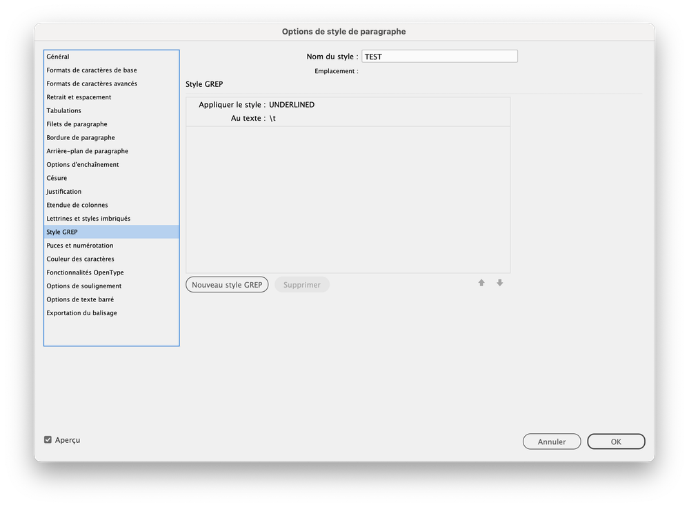

Hi @Thomas_Calvin Maybe I don't understand what you need but I can't see what prevent you to set a paragraph style as below:
Capture d’écran 2025-10-09 à 14.46.40.pngCapture d’écran 2025-10-09 à 14.46.59.pngCapture d’écran 2025-10-09 à 14.47.04.png
Oct 09, 2025 Oct 09, 2025
@jmlevy The OP had a slightly larger gap after the underline and before the text. Also, I don't think the start of the text aligns with the text below. A simple solution would be to enter in two tabs rather than a tab/space.
