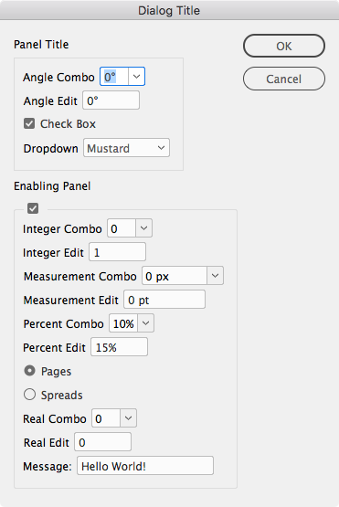

The InDesign dialog building doesn’t kick the user out of the script on a class error, so I’ll use the ID dialog code even when I’m moving between ID and the finder.
This is my reference code for dialog building:
--Complex User Interface Example
tell application id "com.adobe.indesign"
	activate
	set myDialog to make dialog with properties {name:"Dialog Title"}
	tell myDialog
		--the enclosing column
		tell (make dialog column)
			------------------------Panel 1----------------------------
			--a row with title text
			tell (make dialog row)
				make static text with properties {static label:"Panel Title", static alignment:left align, min width:150}
			end tell
			--a panel below the title
			tell (make border panel)
				-- a column inside the panel
					--Angel Combo
						make static text with properties {static label:"Angle Combo"}
						set myAngleCombo to make angle combobox with properties ¬
							{string list:{"0", "90", "180"}, edit value:0, maximum value:360, minimum value:0, small nudge:1, large nudge:10, min width:50}
					end tell
					--Angel Edit
						make static text with properties {static label:"Angle Edit"}
						set myAngleEdit to make angle editbox with properties ¬
							{edit value:0, maximum value:360, minimum value:0, small nudge:1, large nudge:10, min width:50}
					end tell
					--Checkbox control
						set myMustardCB to make checkbox control with properties {static label:"Check Box ", checked state:true, min width:150}
					end tell
					--Dropdown
						set PresetList to {"Mustard", "Relish", "Ketchup"}
						make static text with properties {static label:"Dropdown"}
						set myDropdown to make dropdown with properties ¬
							{string list:PresetList, selected index:0, min width:80}
					end tell
				end tell
			end tell
			------------------------Panel 2 (Enabling)----------------------------
			--title text
				make static text with properties {static label:"Enabling Panel", static alignment:left align, min width:150}
			end tell
			tell (make enabling group with properties {checked state:true, min width:150})
					--Integer Combo
						make static text with properties {static label:"Integer Combo"}
						set myIntegerCombo to make integer combobox with properties ¬
							{string list:{"1", "2", "3"}, edit value:0, maximum value:100, minimum value:0, small nudge:1, large nudge:10, min width:50}
					end tell
					--Integer Edit
						make static text with properties {static label:"Integer Edit"}
						set myIntegerEdit to make integer editbox with properties ¬
							{edit value:1, maximum value:100, minimum value:0, small nudge:1, large nudge:10, min width:50}
					end tell
					--Measurement Combo
						make static text with properties {static label:"Measurement Combo"}
						set myMeasureCombo to make measurement combobox with properties ¬
							{string list:{"10", "20", "30"}, edit units:pixels, edit value:0, maximum value:100, minimum value:0, small nudge:1, large nudge:10, min width:90}
					end tell
					--Measurement Edit. Note max and min units are always points
						make static text with properties {static label:"Measurement Edit"}
						set myMeasureEdit to make measurement editbox with properties ¬
							{edit units:points, edit value:0, maximum value:1000, minimum value:0, small nudge:1, large nudge:10, min width:90}
					end tell
					--Percent Combo
						make static text with properties {static label:"Percent Combo"}
						set myPercentCombo to make percent combobox with properties ¬
							{string list:{"10", "15", "20"}, edit value:10, maximum value:100, minimum value:0, small nudge:1, large nudge:10, min width:50}
					end tell
					--Percent Edit
						make static text with properties {static label:"Percent Edit"}
						set myPercentEdit to make percent editbox with properties ¬
							{edit value:15, maximum value:100, minimum value:0, small nudge:1, large nudge:10, min width:50}
					end tell
					--radiobutton group
						tell (make radiobutton group)
							set myPageRadio to make radiobutton control with properties {static label:"Pages ", checked state:true}
							set mySpreadRadio to make radiobutton control with properties {static label:"Spreads "}
						end tell
					end tell
					--Real Combo
						make static text with properties {static label:"Real Combo"}
						set myRealCombo to make real combobox with properties ¬
							{string list:{".1", ".2", ".3"}, edit value:0, maximum value:1, minimum value:0, small nudge:0.01, large nudge:0.1, min width:50}
					end tell
					--Real Edit
						make static text with properties {static label:"Real Edit"}
						set myRealEdit to make real editbox with properties ¬
							{edit value:0, maximum value:10, minimum value:0, small nudge:0.01, large nudge:0.1, min width:50}
					end tell
					--Text Edit
						make static text with properties {static label:"Message:"}
						set myTextEditField to make text editbox with properties ¬
							{edit contents:"Hello World!", min width:150}
					end tell
				end tell
			end tell
		end tell
		--get the results
		set myResult to show myDialog
		if myResult = true then
			--+1 gets the correct name because list starts at 0
			set myPreset to item ((selected index of myDropdown) + 1) of PresetList as item
			set v to edit value of myMeasureEdit
		else
			return
		end if
		destroy myDialog
	end tell
	display dialog v as string
end tell
