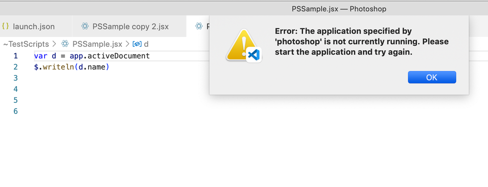

With PS CC2020 running I get this:
If I close CC2020 and open CC2021 the script runs and returns Adobe Photoshop.
By @rob day
That is not surprising - the identifier you're using (photoshop) is entirely ambiguous. I will address this further in a response to your other message below.

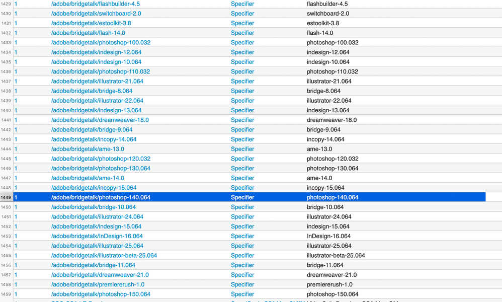

  • /Library/Application Support/Adobe/Adobe PCD/pcd.db
I do not pretend to understand the Schema, nor what might minimally constitute "an entry", but it certainly looks promising. Good luck on your spelunking adventure.
Jun 21, 2023 Jun 21, 2023
Looks promising, but PS 140.064 is in the list:
There is a cache folder in the same directory and if I move that out of the Adobe PCD folder, VS Code doesn’t see any applications. If the dual installation wasn’t working I might try messing with that file, but I think I’ll leave it alone for now. Thanks
