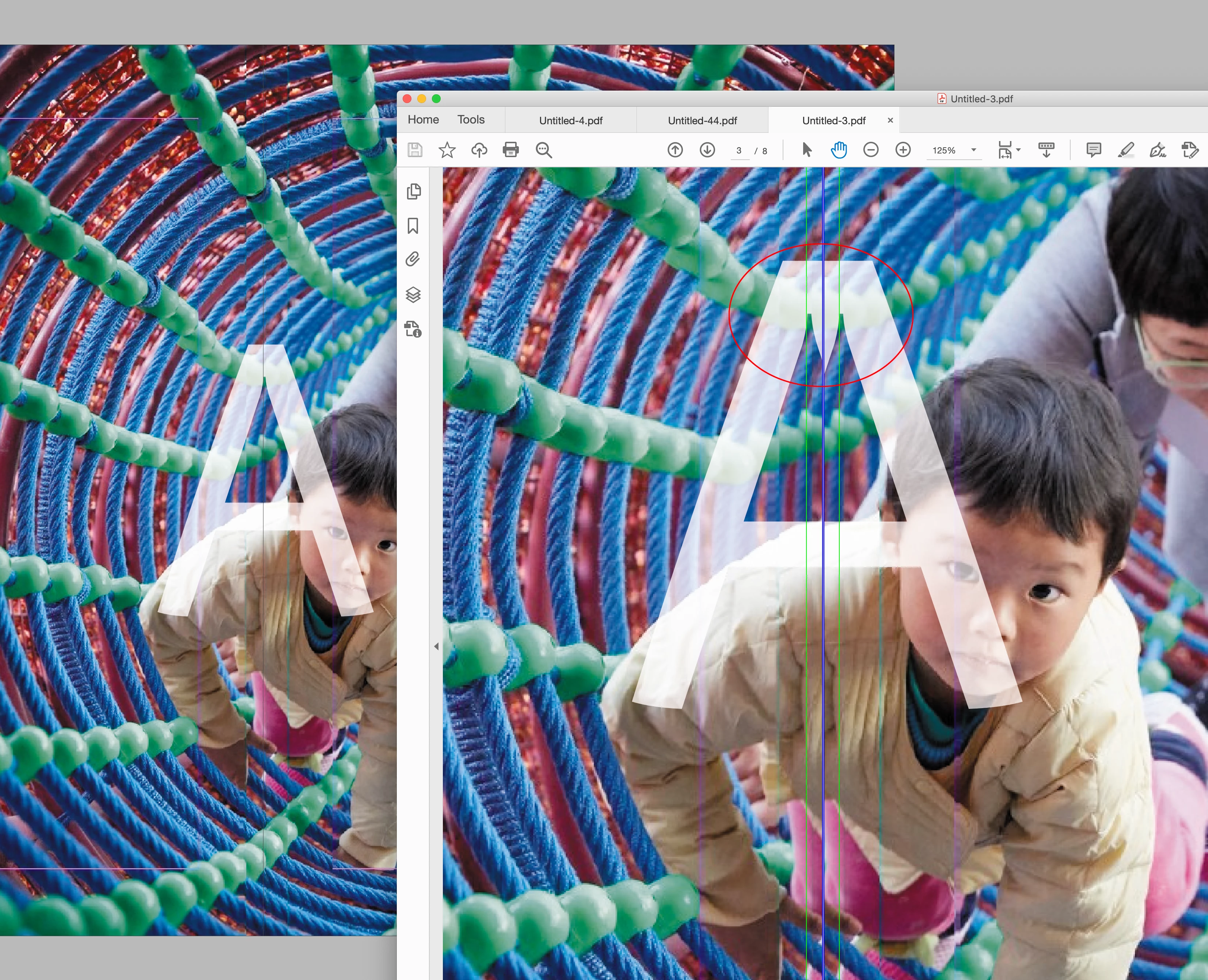

Hi @Susan Culligan , If by gutter you mean the inside bleed, the bleed comes from the opposite page in the spread, so you don’t have to do anything with a crossover image:
If you start moving page items to account for a binding method, you are getting into the page imposition, which should always be handled by the printer.

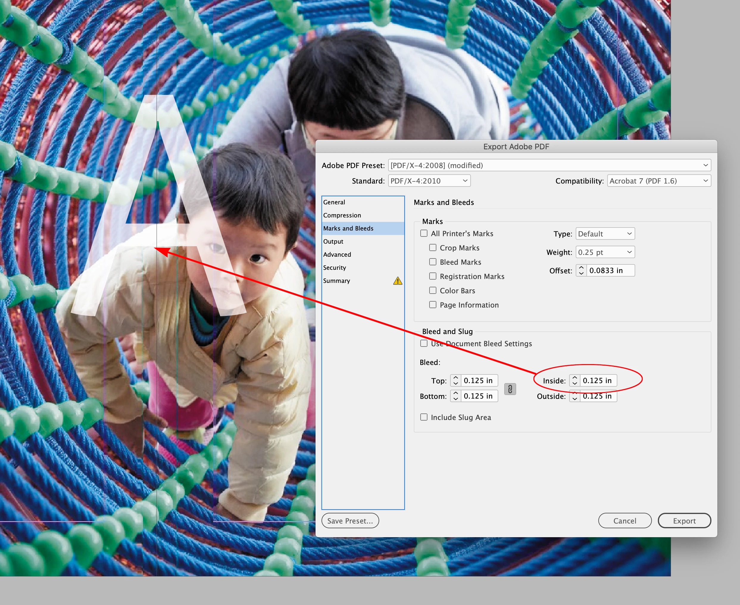

Oy! Are you saying that the printer would take the gutter into account on their end? That would be great.
I think they should with their imposition software. Even InDesign’s basic print booklet imposition can handle how the space between imposed signature pages is handled, surely professional imposition can do the same:
