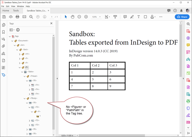

See the example below: when voiced by a screen reader, the table is read correctly without any "path" or <Figure> tags.
A table created in InDesign CC:2019
The exported PDF in Acrobat's Tag Panel: no "path" or <Figure> tags. 
The exported PDF in Acrobat's Content Panel shows all elements in the PDF, including "path".

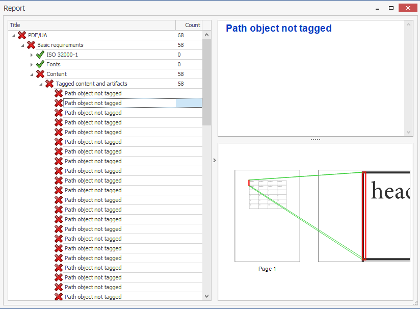

But even though the screen reader reads the file correctly, the pdf will not pass the PAC 3 checker and that is what my client wants. I can remediate the pdf file in Acrobat and artifact all the paths, but I wanted to know if there is a way to do this from InDesign. is there a script for this maybe?
All the Paths will not pass the PAC 3 checker.All the Paths will not pass the PAC 3 checker.

PAC3, CommonLook, and other accessibility checkers are created by commercial companies. There is no checker that is made by the ISO committee itself, which in my opion would be the defacto "one" opinion that would matter.
Although these companies sit on the ISO standards committee with me, we all at times interpret the standards slightly differently. There are several areas of PAC3 that are flagged as errors when, in my firm's opinion, they actually aren't and this is one.
The PDF/UA standard says all viable content must be in the tag tree, tagged with the appropriate tag, and in a logical reading order in the tag tree. The cell borders aren't in the tag tree for AT to access.
Checking the file with real screen reading software, the borders are not announced. Nor do they appear in the Order panel, either. These borders only appear in the  Content Panel which shows every single item in the document file, whether it's viable content or artifacted or neither.
In our shop, this is a "non-error" error. I'd prefer that PAC 3 give us a better feedback on these borders, something like:
  • Do the borders appear as <Figure> or "Path" in the tag tree?  If yes, then flag the error.
  • If the borders only appear as <Figure> or "Path" in the content panel and don't have the Artifact tag on them, then give a warning rather than an error, and recommend manually checking them for compliance.
Keep in mind that all of the accessibility checkers are not the standard itself, but merely someone's interpretation of the standard.
From a practioner's viewpoint...
If my client insisted on perfect compliance with PAC 3:
  • I would select all of the "Path"s in the Content panel and artifact them with a mouseclick.
  • "Gently" educate the client on this issue.
  • And ask the client why they decided on PAC 3 rather than CommonLook or Acrobat's built-in checker.
And in my shop, we use all 3 accessibility checkers as well as a checklist that has items not covered by any of them. None of the software checkers catch everything or evaluate the same items.

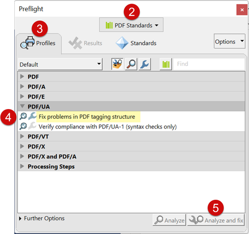

As an added measure to take, run Acrobat Pro's Preflight to identify and correct many of these errors (and others).
  1. From the Standards tool menu, select Preflight:
  2. In the next menu, choose:
    • PDF Standards from the top.
    • Profiles thumbtab.
    • Fix Problems in the PDF/UA section.
    • Then click Analyze and fix.
