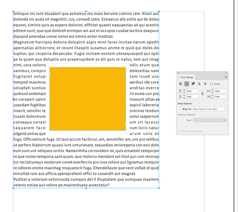

[ 2 ] textWrapOffset does NOT WORK when defined inside properties object.
At least with InDesign 16.4 on my Windows machine. So I added the code for textWrapOffset outside of the property properties.

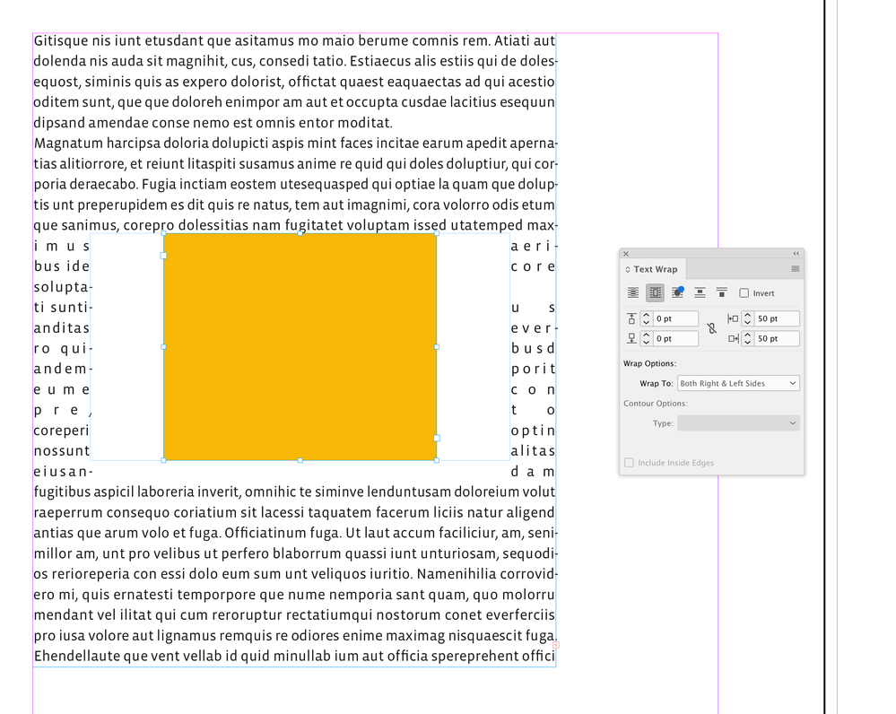

Thanks Uwe, I wonder if the textWrapOffset problem is a scripting bug or something specific to the document we are testing. In general it seems to be working for me with 16.4 on Mojave:
app.scriptPreferences.measurementUnit = MeasurementUnits.POINTS;
var s=app.activeDocument.selection[0];
s.textWrapPreferences.properties = {textWrapMode:TextWrapModes.BOUNDING_BOX_TEXT_WRAP, textWrapOffset:[0,50,0,50] };
