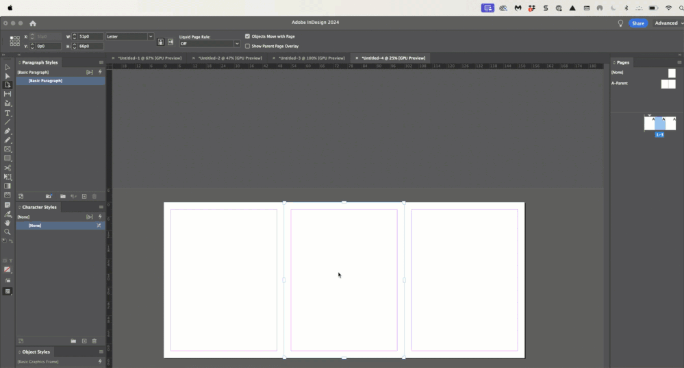

I thought there was a setting that allowed, for example, a three-page spread to automatically adjust if a middle page was adjusted in width.
That is, typical 3-page book cover layout, adjust spine width using Page tool, RH/front cover page automatically snaps to new position.
Can't seem to find the right combination of spread settings for this...

Is this what you are looking for, James?
~Barb
Jun 26, 2024 Jun 26, 2024
Yes, but I'm not getting that automatic snap-together. Same settings I see in the Control Bar, and I either get a change with no snap, or a snap back to the starting width. I'm missing something here., and it's not meretricious.

Are you holding the Alt/Opt key while dragging the sizing handle with the Page tool?
~Barb
That lets me resize without snap-back but does not maintain the snap-together.
This is bats. I've done three-page layouts many times and never lost that "sticky" adjustment.
Hi James, I find it easiest to use the Transform panel—select the center page with the Pages tool, and set the Transform panel Width—but as @Barb Binder suggests holding down the Option/Alt key should work when you drag a handle:
Yes, I just crawled in here, slug-like, to add a note that none of the above works unless you have Facing Pages checked, which was the very, very last thing I found after adjusting every setting, trashing my prefs, etc.
Which, on some level, I knew from a prior discussion.
It's the heatwave. Yeah, that's it.
May this signpost in the desert do someone else some good some day. 😛
