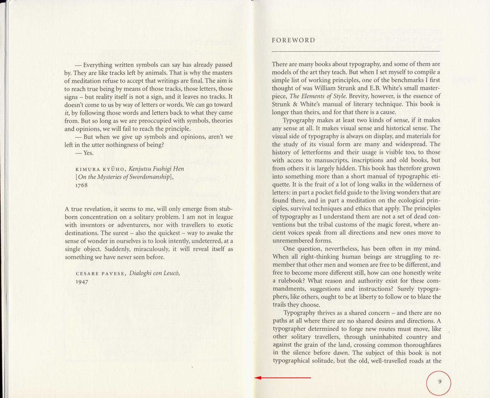

Yes but the odd numbered folios are to the right of the spine. And there’s no problem with running crossover images across the spreads of facing page documents. A self cover book would have the inside cover included as the physical page 2 to the left of the spine—with facing page documents the spine is the center of the spread:
The folded and gathered signature:
Oct 17, 2022 Oct 17, 2022
Odd numbered folios are always printed on the page to the right of the spine:
