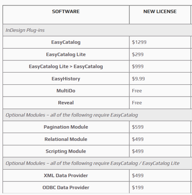

65bit Easy Catalog Lite is $299 but appears to need updates for new ID versions. They have (much) more expensive option but that probably wouldn't be necessary.
