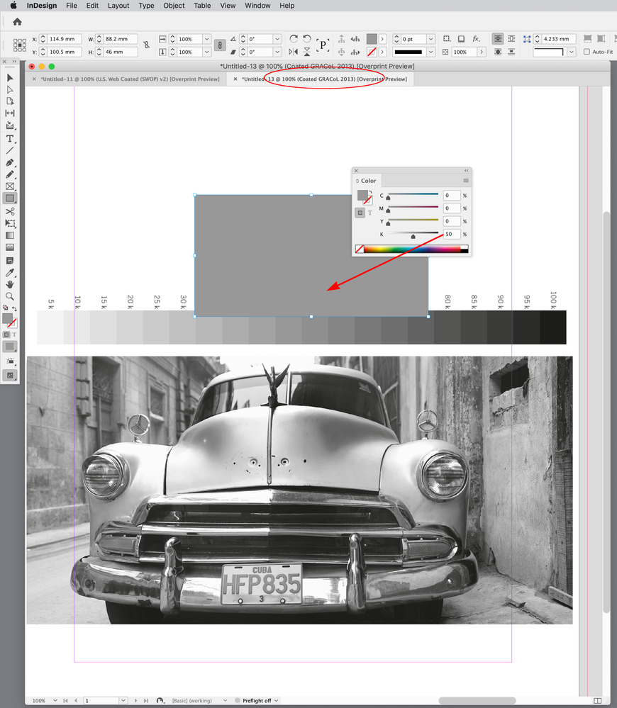

Also,  it might be worth noting that if you are setting your documents up using the default Color Settings—where the assigned document CMYK profile is the offest press profile US Web Coated SWOP—that profile’s black ink soft proofs and converts to RGB with a blue cast.
You can see the cast if you make a CMYK fill with 50% Black in a US Web Coated SWOP document and convert the fill to RGB—the conversion isn’t to a neutral RGB value, and might print as a cast on an RGB driven composite printer like your Epson. Note the 5 level difference between the red and blue channel on a conversion:
Every CMYK profile defines the color of offset black ink differently. GRACoL Coated 2013 is very close to neutral, so you could try setting up a document with that CMYK profile and see if it helps. The old Photoshop 5 Default CMYK profile also displays a perfectly neutral black ink.

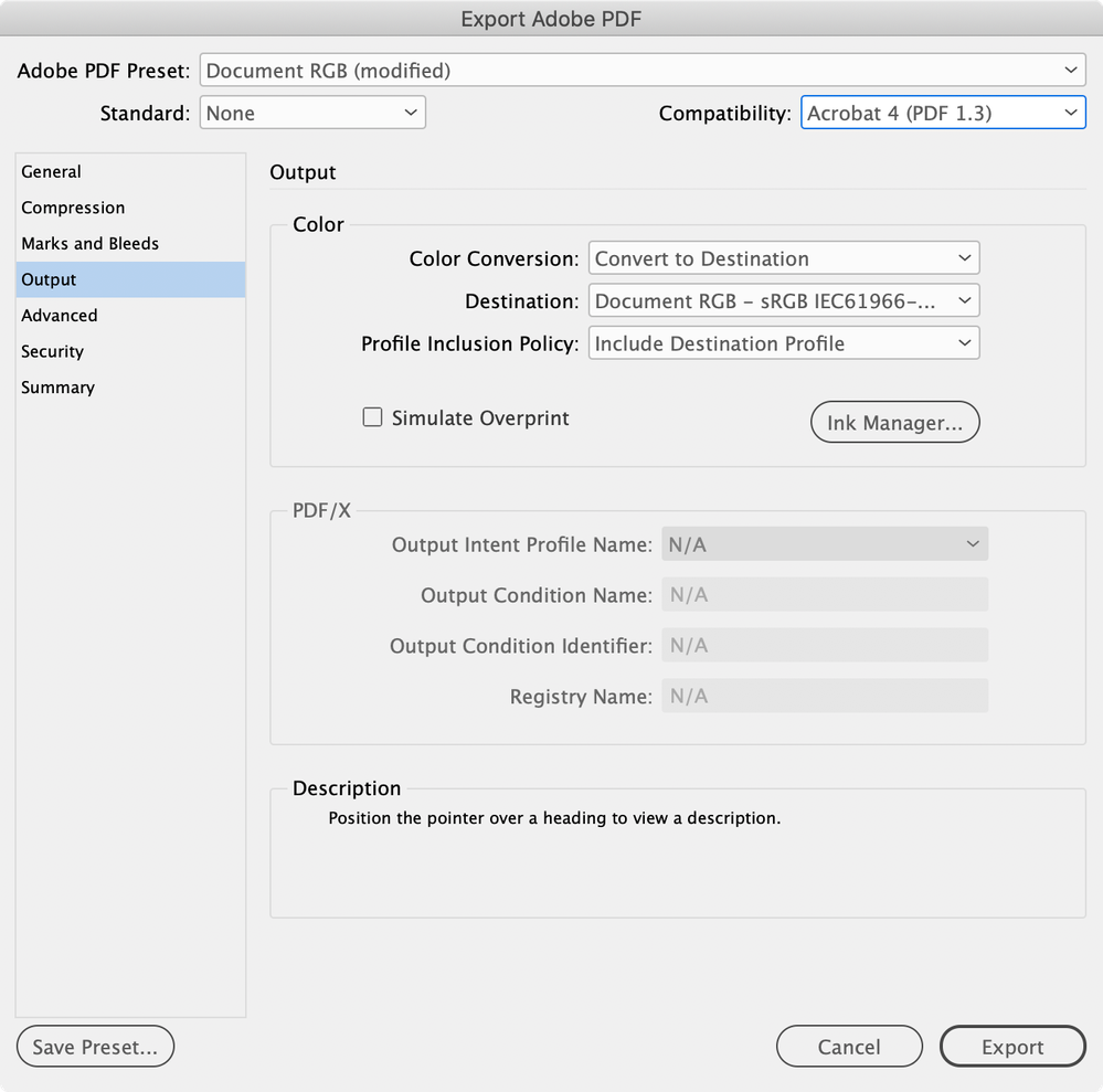

If you export a PDF and print from Acrobat, what are your Export>Output tab settings? Does this setting affect the Epson gray balance? Compatibilty Acrobat 4, Convert to Destination, Document RGB, Include profiles:
Dec 01, 2022 Dec 01, 2022
Also, you have to check Simulate Overprint to force the RGB conversion. And when Exporting to an RGB Destination, it might help to set your Appearance of Black Print/Exporting Preference to Output All Blacks as Rich Blacks.
