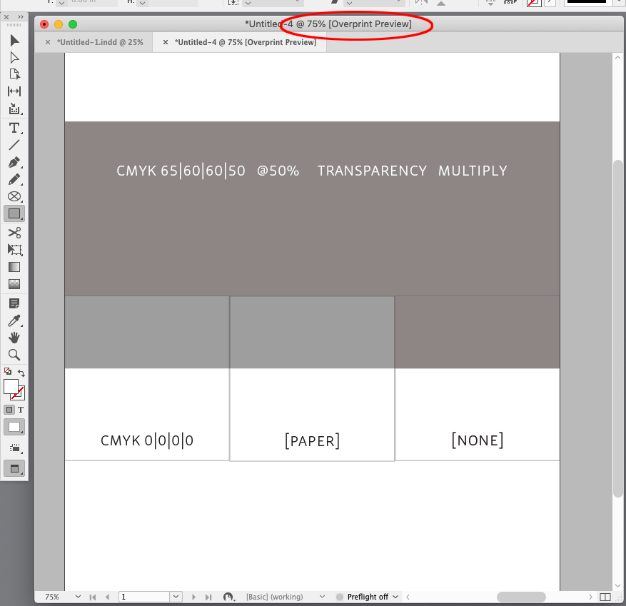

If I make a CMYK 0|0|0|0 White swatch and use it as the fill for the container frame holding a transparent PSD it will preview differently depending on whether Overprint Preview is turned on, but the output values for [Paper] and 0|0|0|0 White will be the same:

Overprint/Separation Preview On:

The color of the [Paper] swatch would have some affect on the softproof of the image (Overprint Preview turned on), but not its actual output values. These 3 pages would have the same CMYK output values—the appearance of the printed CMYK values would be affected by the paper’s color because offset inks are transparent:

It’s worth noting that the Overprint Preview (the print soft proof), and the Transparency Blend space settings can have a significant affect on the appearance of a [Paper] filled object when it is interacting with transparency—for print projects you really have to pay attention to the Overprint/Separation Preview setting.
Here the Transparency Blend Space set to CMYK with Overprint Preview turned on and off:
Same page with the Transparency Blend space set to RGB:
