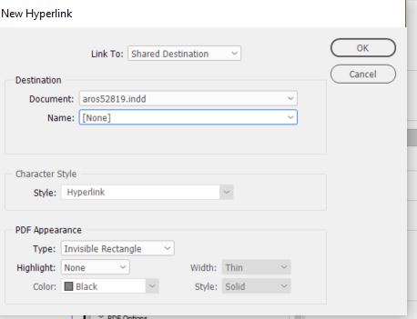

before any exporting, when trying to create page navigation, -table of contents to a page- using the 'shared hyperlink destination' option in the 'new' hyperlink window <ABOVE> the destinations I can choose from (where 'none' is) are not from the document I'm trying to create but from earlier docs, the one you see, the aros52819 is the file but the links that drop down are not from that doc at all. How can I make sure that when I place an image that it will be available to me using this method?

if not shared hyperlinks, what would you use to link the title in contents to the image? I tried hyperlink -to page, but it said thats not done in interactive pdf's. I went into this with the idea it would be at least as easy as back a few years ago when I did one with html but have run into image size problems, navigation issues, source-destination confusion...

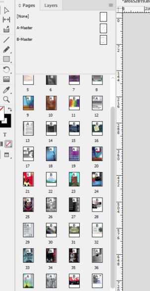

titles hyperlinked.JPGand then highlighted each title to create a hyperlink to the corresponding image/page. Each page consists of one image like a regular picture book. Theres a poem but  part of the jpeg, so no text.

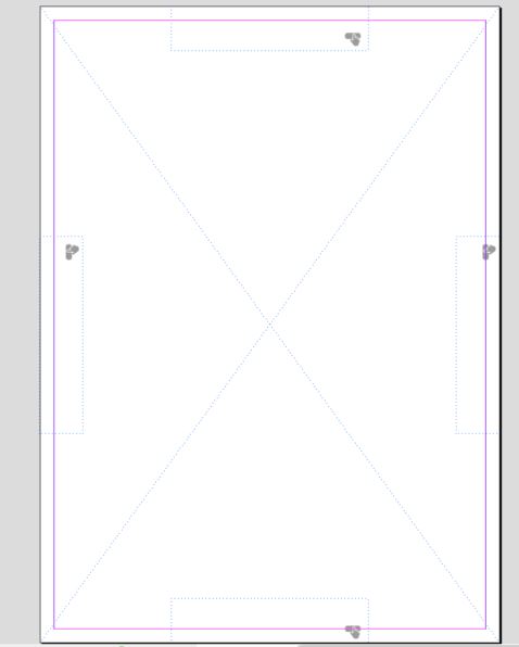

pages.JPGOn the master I put next, prev, home (contents) as buttons, buttons on master.JPGthey seem to work on the exported pdf.
In the new hyperlink window I tried 'shared', new.JPGthat doesn't work because I can't find the files in the shared dropdown list. I tried to link to a page but that doesn't work with interactive pdfs, nor does it seem to be working when I link it to the file (on my computer). It ALL works beautifully in the swf preview....

On that assumption, maybe instead of hyperlinks use the Buttons and Forms panel. Windows/Interactive/Buttons and Form. You  can convert your thumbnails (or whatever) to buttons. Then, using the Buttons and Forms panel, set actions to them like "On Release, Goto Destination." Actions should be grouped based on output form so some may work in EPUB, others may not. Just be aware I guess.
As to the whole shared links thing, don't use "Shared Destination" as that can create all kinds of grief. I'm not saying avoid it forever and always, but I doubt that's really what you need here. If you end up using buttons, then that shared link thing may fix itself.
