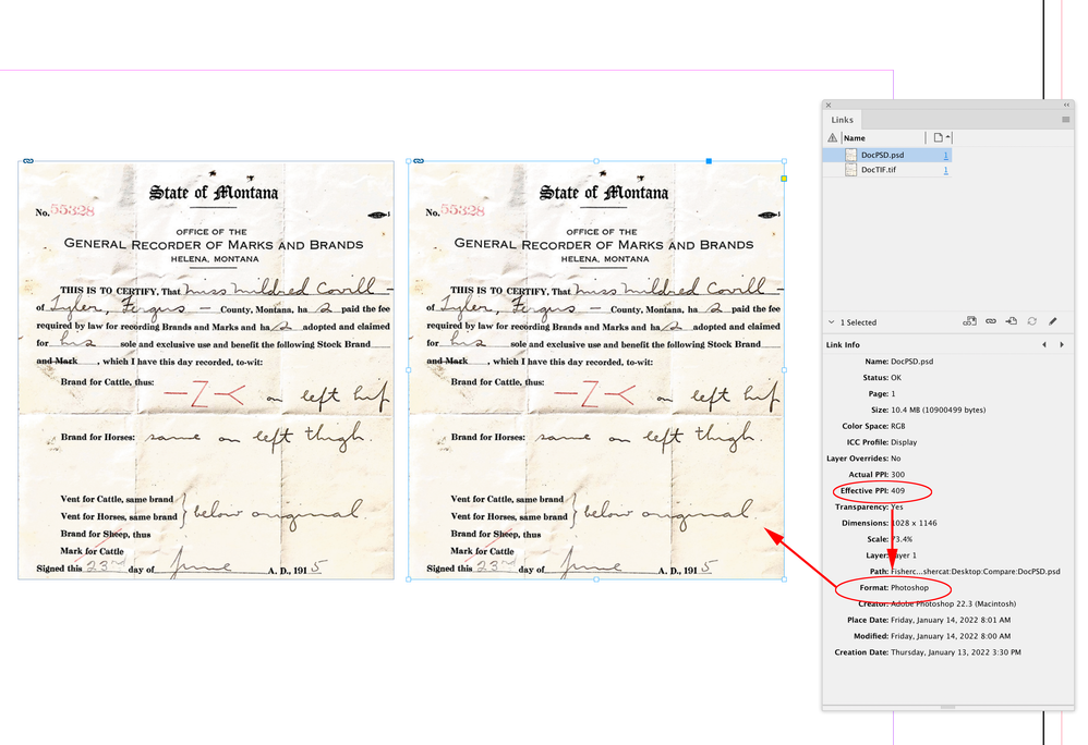

Hi Derek, I think there are other problems with placing JPEG—it’s a flattened format so any edits done via Photoshop layering would be lost on a save to JPEG. Multiple color corrections done directly to the pixels, and not via Adjustment layers could do real damage to an image. PSD also has the Object Layer Options feature, which is not available with TIFF.

Well you always save your layered PSD in case you need to do further editing, but as I said as the first replyer in this thread, Place native PSD files in your InDesign document.
