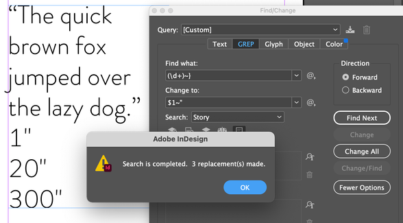

Correct answer Barb Binder
Hi @DigitalChickster
Try this, which will change a curly quote after a number to an inch mark, but will leave the quotes after words alone.
GREP tab
Find: (\d+)~}
Change: $1~"
~Barb

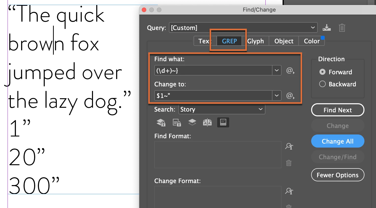

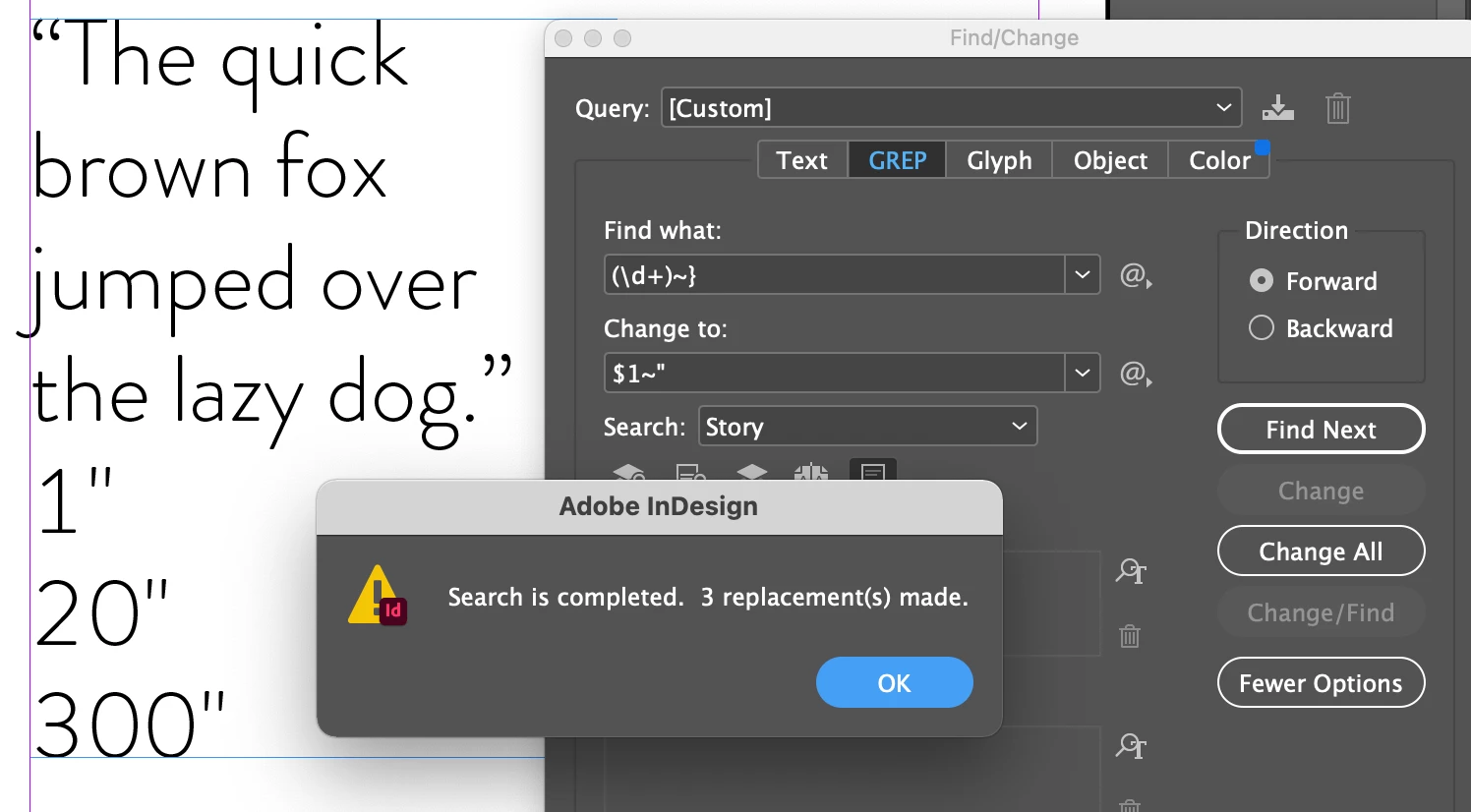

GREP tab
Find: (\d+)~}
Change: $1~"
~Barb

YES! That did the trick! You are a rockstar. Thank you so much!!!!!
