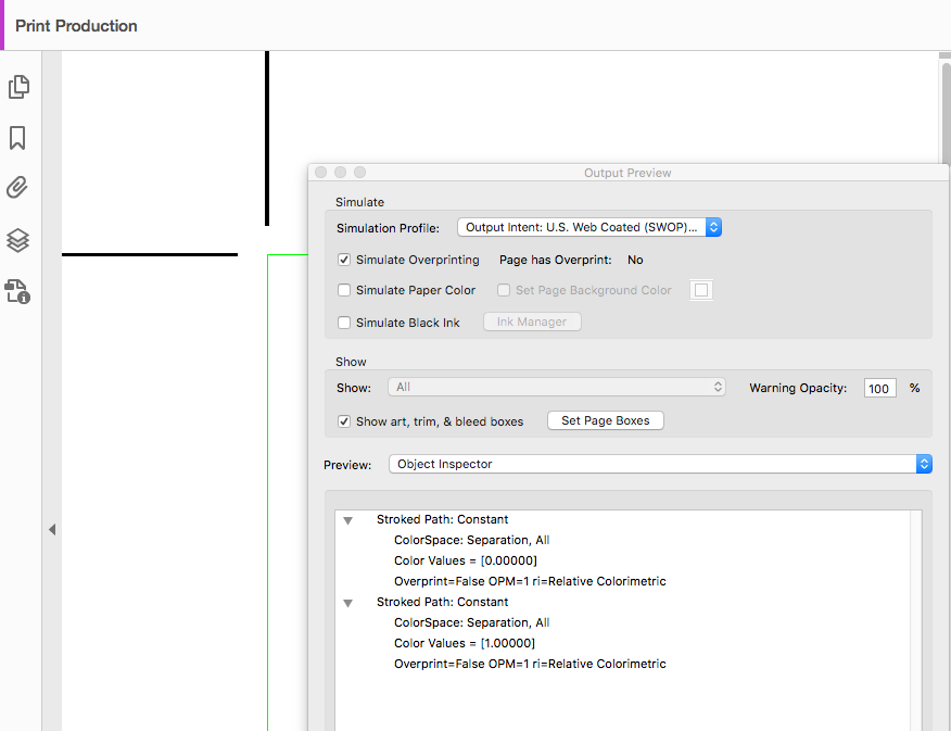

No. The PDF cropmarks’ Color Space in Acrobat is Separation, All

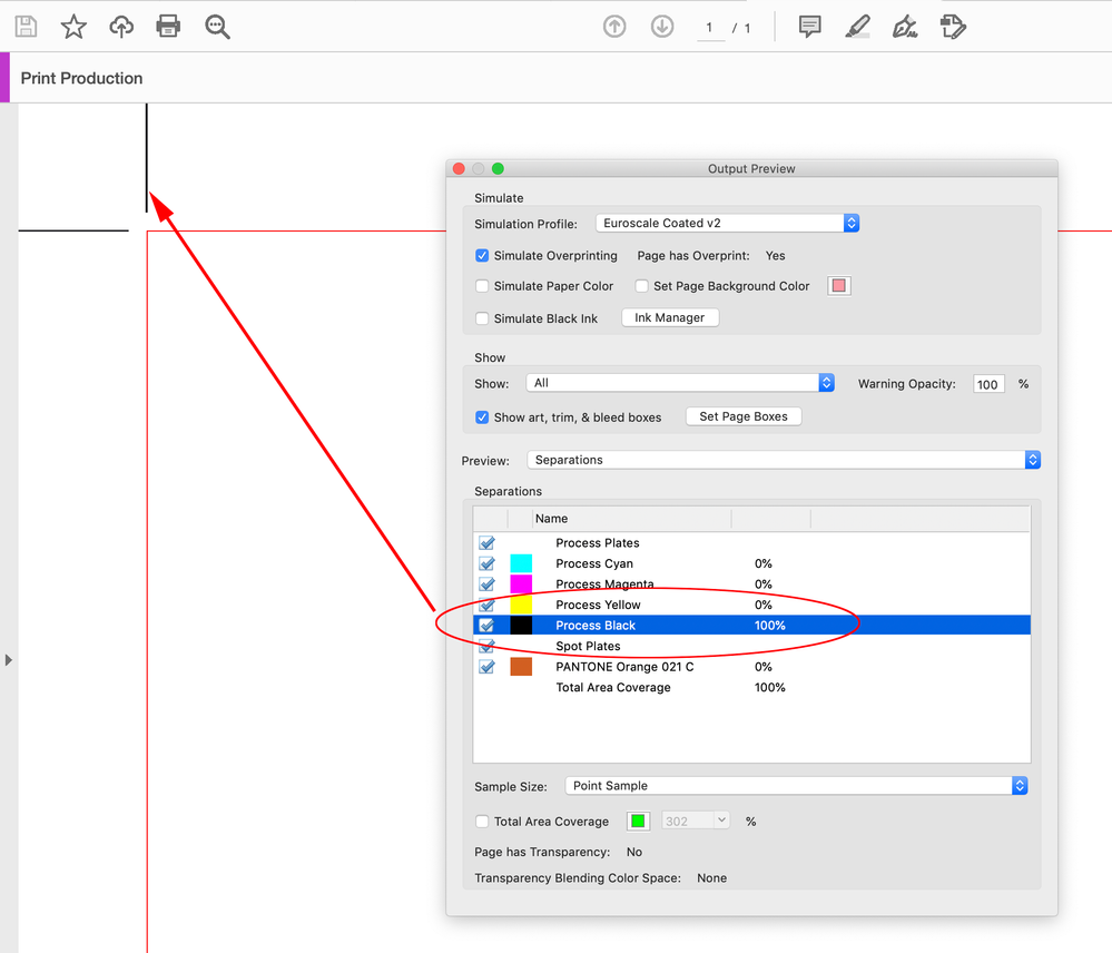

Try @rudo123’s PDF Preflight fix—looks like it could be scripted:

You can fix it in Acrobat / Print production / Preflight / Fix / Convert registration color to CMYK black only (but, probably this is your not really good workaround):

You are a lifesaver. I've been looking for exactly this function for so long! Thank you.
Community Beginner ,
Dec 01, 2022 Dec 01, 2022
PERFECT! Thank you. This fix is a keeper as I run two and three color jobs all the time and like to have crops and page information on all my print res docs.
Explorer ,
May 26, 2023 May 26, 2023
Where has this solution been all my life?! So glad I decided to try searching the community for this solution again! This is such a huge help to another fellow digital printer! Kudos to you!
