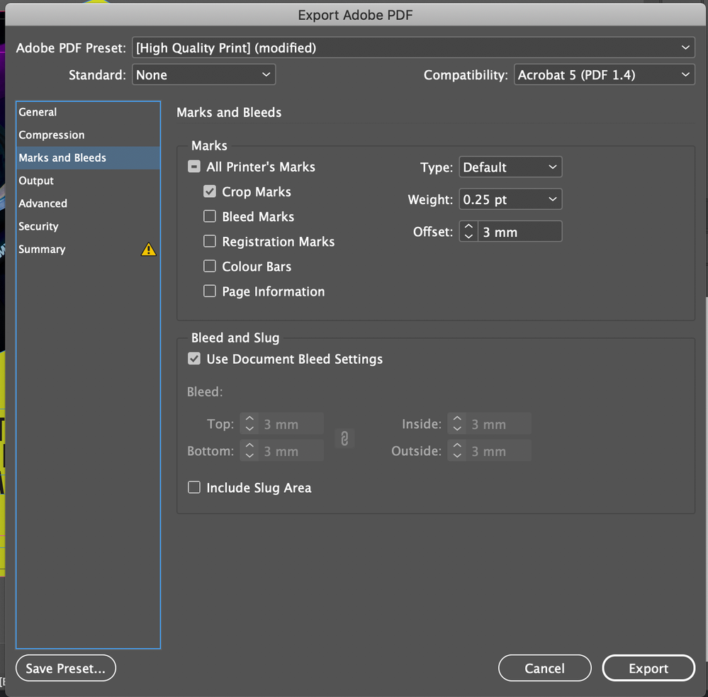

Hi, I am slightly when setting up my pdf for print. I need no explanation of what a bleed and crop mark do in a PDF but for some reason my crop marks seem to sit inside the image, acting as a bleed mark and then when I go to slect bleed marks they act as crop marks sitting on the outside of my bleed! It's so confusing and have no idea why my file is acting in this way! Please see attached images to help explain...

November 19, 2020

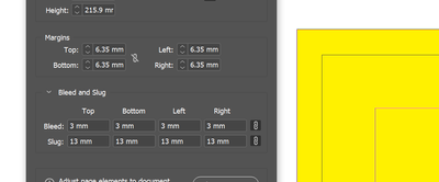

You have Crop Marks, not Bleed Marks checked. The Offset and Bleed amounts are both set to 3mm so the crop marks in the PDF are correct.
