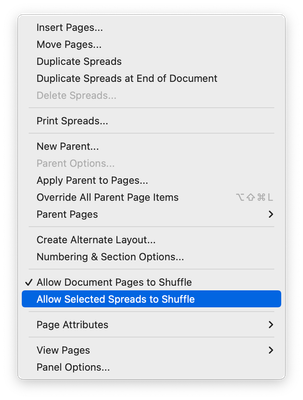

Ok. So first open the Pages Panel and select all pages starting with the first page then SHIFT clicking the last page. All the thumbnails should be selected now. Then go the Pages Panel flyout menu and deselect the option “Allow Selected Spreads to Shuffle”.

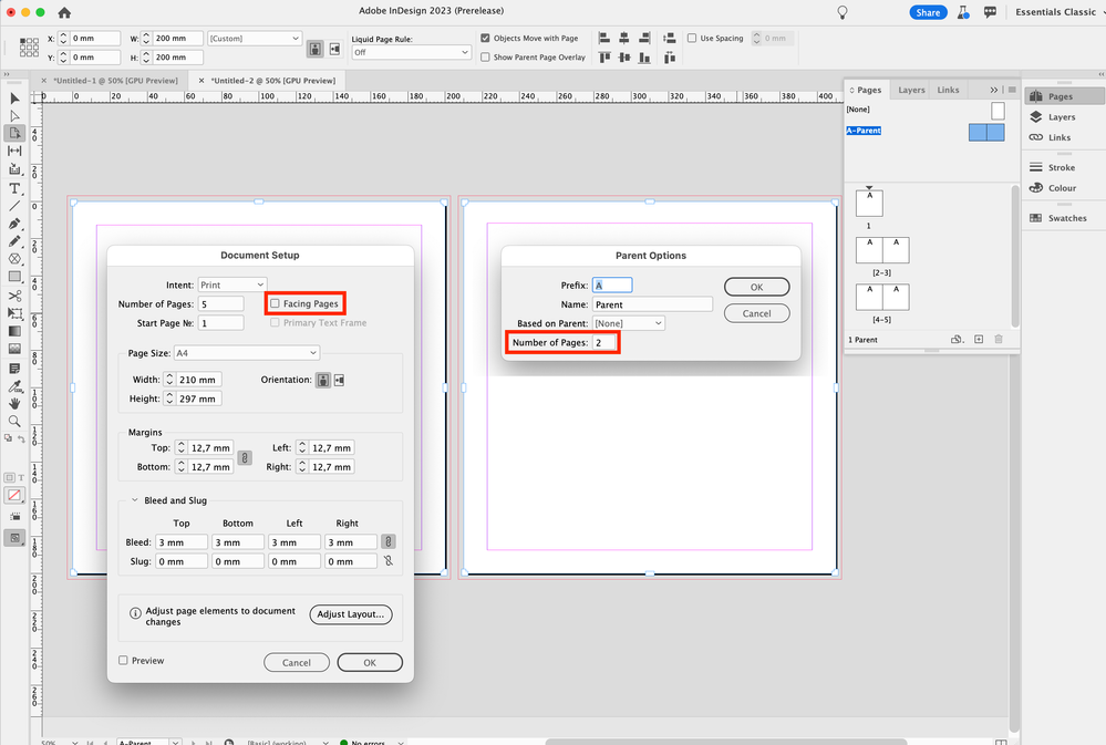

Please show us your pages setup, so we can properly help you. As Rob already pointed out if you have elements on the inside they need their own bleed (for Wire-O binding) which is only possible when using the method he describes in the link he added to his post.
If you setup your document with no facing pages but have two pages for your parent pages it will allow you to move the pages apart from each other having bleed around both pages.
All spreads should now have square brackets around their page numbers. Then go to Document Setup and tick off “Facing Pages”. InDesign will ask you if you want to keep the page numbering. Click yes. Now you will be able to move the pages apart from each other. Use the Page Tool for that (Shortcut SHIFT P). Adjust your bleed on the inside if necessary.
