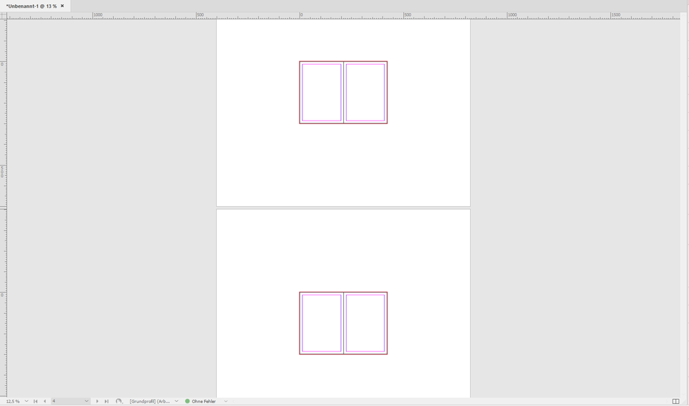

Hi together,
another method is to move the left or the right page with the Page tool so that both pages do not meet in the spine.
For this to do you need more space around the facing pages of a spread. Let's say 400 mm below and on top of a A4 document. Moving the pages can be done in one go if you first select the Page tool, then select every odd page in the Pages panel. The next step would be to use the Transform panel to move the selected page down or up with about 5 mm more than the page height.
From my German inDesign 2023 on Windows 10:
Result:
Result in detail:

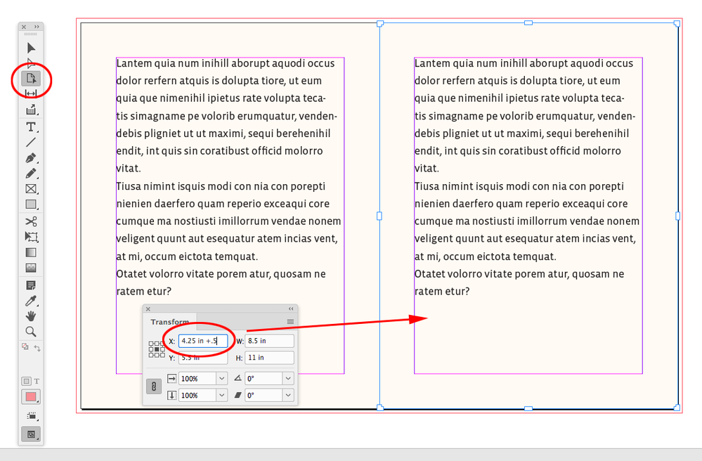

A document setup with Facing Pages turned off can still have 2 page master spreads. A non facing page document allows you to use the Pages tool to reposition the pages—select the right hand page of the spread and either drag it or use the Transform panel to move the X position.
If the document is not setup as Facing Pages the Paragraph justification setting Align Toward Spine does not work correctly
Setting the left text to Align Toward Spine does not work:
