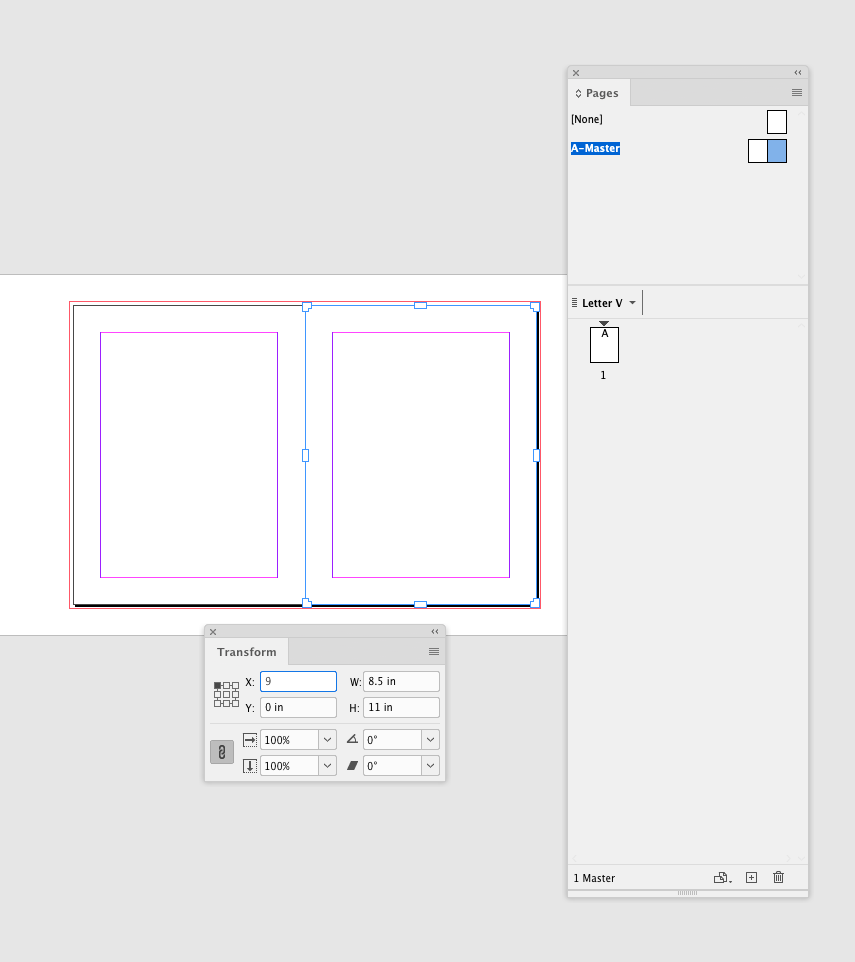

Does the printer care about the bleed content? She may just want it for an imposition template. You can include a inside bleed with facing pages, it just comes from the opposite page, which is what you want for crossovers.
With non facing pages you can still make a 2 page master:
