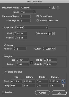

When you set up a new document you need to firstly specify the size -- known as the trimmed page size (TPS), to this you add the bleed, usually 3mm / 1/8". If it's a one page document you add it to all edges, if it's facing pages (surch as in a book) you don't have bleed in the centre. You indicate your margins -- your choice. When you output the finished document for your commercial printer you produce a PDF. Check the spec required with your printer, usually PDF/X-4, single pages (not spreads), tick Crop Marks and Use Document Bleed Settings.

If your printer wants  PDF/X-1a then you can get this preset from InDesign (it is an old version with some disadvantages).
I attach a screen shot of how you might set up a new 8.5" x 8.5" document with facing pages and bleed (I havent bothered with margins, which you can decide on) and how it would look in InDesign showing the bleed area and how the illustration would be trimmed.
