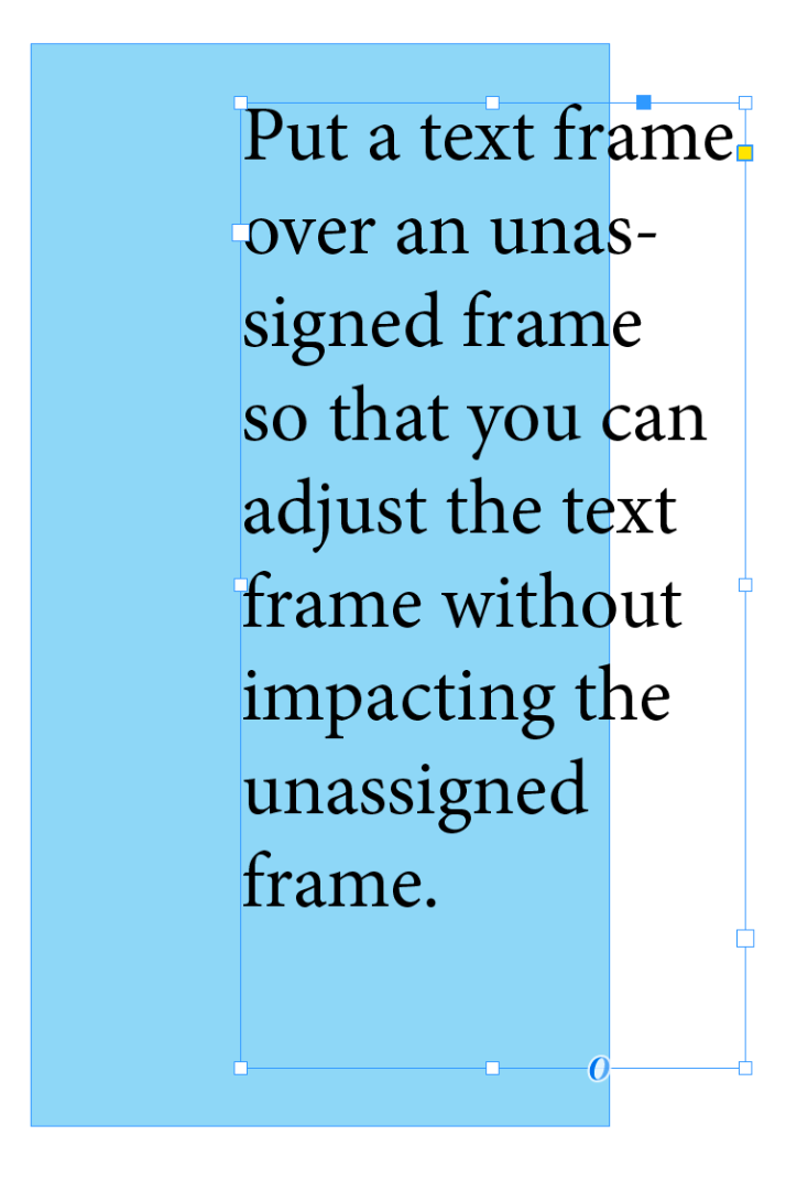

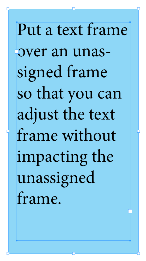

Hi Bruce:
I'm guessing you must have a single text frame, with the blue added to it. To be able to manipulate the two independently, add an unassigned frame under the text frame, remove the blue from the text frame, and add the blue to the unassigned frame.
~Barb

Hi Bruce:
Actually, when I try to move the text block my screen comes with it.
Yes, because you are working with a single frame instead of two.
InDesign offers three types of frames: add a text frame with the Type tool (the T); a graphic frame with the Rectangle Frame tool (the rectangle with the X inside); and an unassigned frame with the Rectangle tool; (the rectangle without the X inside). You want two frames here—as shown in my screen shots, above.
