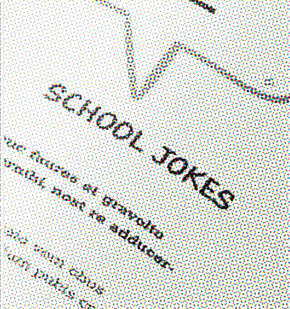

The gray text in your PSD image is Device CMYK, and is likely outputting as 4-color, so the resolution of the output device's halftone screen (LPI) is going to have an effect.

Sep 07, 2023 Sep 07, 2023
Hi Uwe, I was thinking more about the proofing or output device’s screen resolution. If it’s a proofing device outputting to a halftone screen, its maximum LPI resolution could be relatively coarse, which might be more obvious in the small text areas. For example here’s a 100 LPI simulation of the 300 PPI image out of Photoshop where the rosettes are 4-color:
