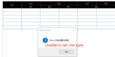

Hi m1b.
I am sorry, I still couldn't help myself. Confusion is torture.
When there is only one row in the header, it can be directly converted to a header.
like this:
var doc = app.activeDocument,
selectedRows = getRows(doc.selection[0]);
var headerRows = convertToRowType(selectedRows, RowTypes.HEADER_ROW);
But when there are cross row columns, conversion is not allowed.
Sometimes it needs to be converted to BODY_ROWS, and sometimes it needs to be converted to HEADER_ROWS.

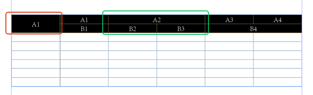

Hi @dublove , It sounds like you are expecting row 1 to have 9 cells, but it only has 5:
//selected frame’s first table’s first row
var c = app.activeDocument.selection[0].tables[0].rows[0].cells
$.writeln(c.length)
//returns 5
for (var i = 0; i < c.length; i++){
    c[i].fillColor = "Black"
    c[i].fillTint = 20

@rob day
Note that I selected two rows at the same time.
At this point, cross-rows(spead rows) merging is involved. You need to cancel the merge first, then convert to HEADER_ROWS (or BODY_ROWS), and then restore the merge.

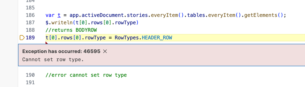

Not sure what you are trying to do, but if it’s convert the first 2 rows of your example to headers, that throws an error
var t = app.activeDocument.stories.everyItem().tables.everyItem().getElements();
$.writeln(t[0].rows[0].rowType)
//returns BODYROW
t[0].rows[0].rowType = RowTypes.HEADER_ROW
//error cannot set row type

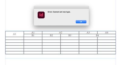

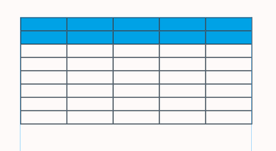

Looks like the error is happening because you have split the rows. If I run this in a table that has not been split:
var c = app.activeDocument.stories.everyItem().tables.everyItem().rows.everyItem().getElements()
try {
    c[0].rowType = RowTypes.HEADER_ROW
    c[1].rowType = RowTypes.HEADER_ROW
    alert("Rows 1 & 2 have been converted to headers" )
}catch(e) {
    alert(e)
Run on your table with split rows:

Hi @rob day
Normal rows without split rows are converted to HEADER_ROWS, which is not difficult.
This is not a problem.
The issue we are discussing is:
How to convert split rows to HEADER_ROWS.
How to resolve this bug.
m1b attempted to resolve this by first canceling the merge and then restoring it, but was unsuccessful.

You would have to create the headers before you merge the cells
//get the rows of table 1 of story 1
var r = app.activeDocument.stories[0].tables[0].rows.everyItem().getElements()//
try {
    //set the first 2 rows to headers
    r[0].rowType = RowTypes.HEADER_ROW
    r[1].rowType = RowTypes.HEADER_ROW
    //merge cell 1 of row 1 with cell 1 of row2
    r[0].cells[0].merge(r[1].cells[0])
}catch(e) {
    alert(e)

Aug 19, 2025 Aug 19, 2025

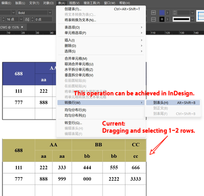

@rob day  @m1b
What I mean is,
I plan to select the first two rows. Convert their row type to HEADER_ROWS.
Note that I selected them by dragging. But that's not critical to solving this bug. The key is whether the conversion to HEADER_ROWS can be performed during the decomposition process.
If there are no cross-rows, the conversion is fine.
Check out m1b's original post; he set up a function called getRows();
I can get the length of the selected rows, so I can operate on any row.
If there are merged cells, it will prompt that the row type cannot be set.
In m1b's solution, A. first unmerge the cells, C. then merge the cells again.
I think if we can (i.e., after A unmerges the cells), B. immediately convert to HEADER_ROWS, C. then merge the cells again.
That would solve the problem, but A and C seem to be inseparable.

This code always fails because the cells are merged before the headers are set
try {
}catch(e) {
    alert(e)
This works on a table with no header rows set or cells merged
try {
    //set the heads before merging
}catch(e) {
    alert(e)
Guide ,
@rob day Please refer to my previous reply.
These two pieces of code don't work either.
My question is, does it work with span rows?
It should work in all cases.
My goal is to fix the bug.

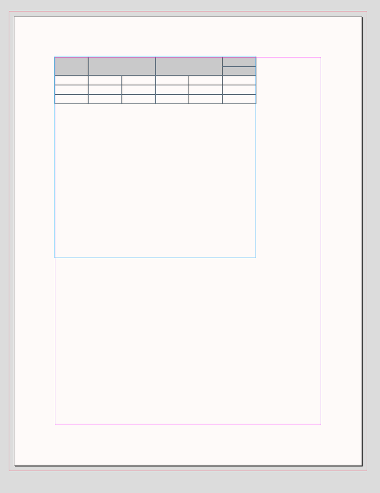

You would have to start with a new table or construct the table via scripting. This makes a new table on page1:
//using millimeters
app.scriptPreferences.measurementUnit = MeasurementUnits.MILLIMETERS;//
var d = app.activeDocument
//add a text frame on page 1 of active document
var f = d.textFrames.add ({ geometricBounds: [25,25,150,150]})
//add a 6 column table to the text frame with 2 header rows
var t = f.tables.add ({columnCount:6, bodyRowCount:3, headerRowCount:2, width:125})
//get the rows
var r = t.rows
//merge header cells
r[0].cells[1].merge(r[1].cells[1])
r[0].cells[2].merge(r[1].cells[1])
//header color
r[0].properties = ({fillColor:"Black", fillTint:20})
r[1].properties = ({fillColor:"Black", fillTint:20})
app.scriptPreferences.measurementUnit = AutoEnum.AUTO_VALUE;

Aug 26, 2025 Aug 26, 2025
@m1b @rob day
This operation can be achieved in InDesign.
Then the script should also be able to achieve it?
Perhaps only InDesign developers know the answer to this.
Just like how right-clicking an image edited in Photoshop in the Links panel automatically updates it.
