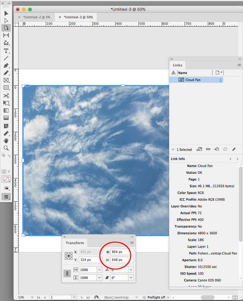

Also, if for some reason you want to measure actual image pixels, rather than the page item using the static InDesign Pixel ruler unit, you could get a pixel measurement multiplier by dividing the image’s Effective Resolution by 72.
So rather than setup the page as 4800 x 3600 pixels (which would have a large print output of 66.66" x 50" or 1693mm x 1270mm), I could setup the page as 12" x 9" (304.8 mm x 228.6 mm). In that case my placed 4800 x 3600 px image scaled to the page size would have an Effective output resolution of 400ppi (see Link Info).
The pixel measurement multiplier would be 5.55555556 (Effective Res/72). Here the Transform panel gives the dimensions of my 12" x 9" page in Millimeters:
If I set my rulers to Pixels, the page and background image width measures as 864px. If I multiply by 5.55555556 I get the image pixel width of 4800px.

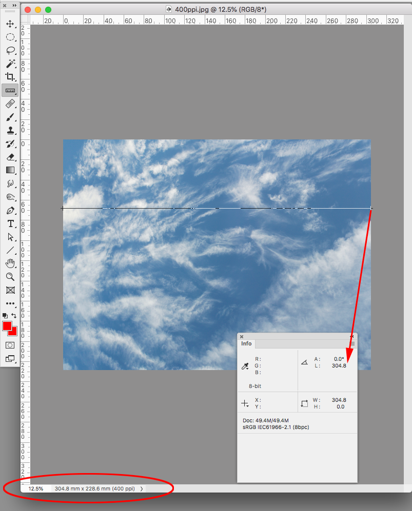

If I needed to export the 12" x 9" page to an image format at a pixel dimension of 4800 x 3600 px, I would set the export Resolution to 400ppi. The export to JPEG at 400ppi with Photoshp‘s rulers set to Millimeters:
