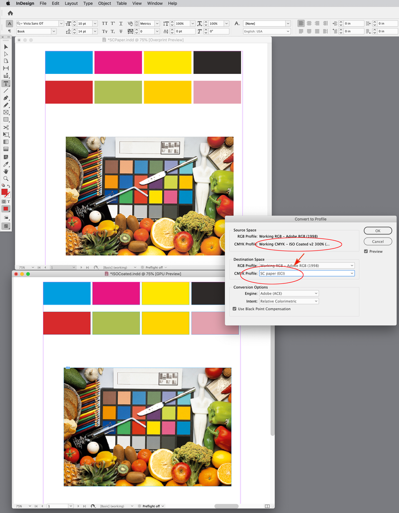

If you care about matching appearance then you would have to use Edit>Convert to Profile... rather than Edit>Assign Profiles... Here I started with a document that has ISO Coated assigned as its CMYK profile (bottom), duplicated the doc and converted its CMYK colors to the SC Paper profile (top). The converted document now has new CMYK values, but with SC Paper assigned as its profile, so its native color appearance doesn’t change:
Now if I Export both docs to PDF/X-4 with the Destination set to Document CMYK everything matches and the exported PDFs have the correct PDFX Output Intent:
