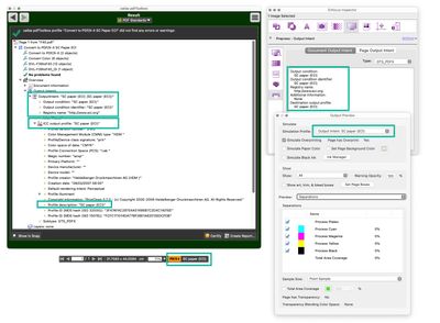

My following question is a larger topic, but I just want to keep it as simple as possible: PDF export to InDesign with a press-ready color management.
The framework conditions: MAC OS, InDesign CC21, Adobe DC Professional, callas pdfToolbox (as a plugin or use independently of an application). The output (ISO Coated V2 for the cover and SC paper (ECI) for the content) goes to a printing house.
In recent years, our workflow has been as follows:
- do the job with InDesign
- Export PDF
- Separating the pages into individual pages
- Converting colors in Acrobat using the pdfToolbox plugin (this step for SC paper content only)
- Profiling PDF X4 (with custom profile) in Acrobat with pdfToolbox plugin
After that, the catalog was ready for printing. The conformance in Acrobat shows (for the content): PDF/X-4, Identifier is FOGRA40 and Profile Info is SC Paper (ECI).
I'm wondering if I don't use the plugin and create the color conversion job using the Adobe tools, can I get the same result with it? Please see the screenshot showing the settings in the InDesign exporter.
Of course I've already tried it, but in fact it was a big visual difference to the result with the callas pdfToolbox. So something might not be right there.
Color management is a big topic, I know, but what's the mistake in this case? To me the way with onboard tools sounds reasonable. 🙂

What really helps me here is a "brave", concrete answer as to whether my settings are objectionable in this form when exporting to InDesign, or whether they are correct (see attached image in my first post). They look logically correct to me, but unfortunately sometimes you don't see everything yourself. So I take from rob days' first answer that they are probably correct. It's good. Also, his answer confirms my suspicion that you don't actually need any additional software. The only thing I miss here is the (automatic) identifier "FOGRA40". I don't know how important that is. The printer's specifications require it. It can be entered manually in the export settings under "Identification of the initial condition". This has no effect, it is only displayed.
The only reason I haven't marked the answer as correct so far is that I'm still unsure overall. As described, I get different results with the two methods. See also my 4 attachments with the color samples. That led me to my next question: about the settings in callas. These are numerous and require a lot of expertise. But I don't want to go into that any further now. As I noticed, only a few people in this forum have experience with the pdfToolbox. Nevertheless, I have attached a screenshot of the profile I created in callas.

Hi @cmoke73 , You may already know this, but when you Export to PDF/X and set a Color Conversion Destination all the color in the document gets converted to DeviceCMYK—CMYK with no profile. The X Standard requires an Output Intent profile to be included so the intended destination is known, but the converted CMYK color objects themselves get no profile.
Here I have Lab and RGB fills, and a placed AdbobeRGB image. I’ve set the Destination to Document CMYK and manually entered FOGRA40 as the Identifier, but that info won’t have any affect on the conversion to Document CMYK on export:
If I check the page items with AcrobatPro’s Object inspector, they all inspect as DeviceCMYK—no profile:
If I run a Preflight to check for PDF/X-4 compliance the PDF passes, and the Identifier I manually entered in the InDesign Export dialog is listed:

Hi @cmoke73 , The job isn’t going to be imposed for, or print on the same press sheet, so I think you would be better off creating a separate document for the cover pages— cover, inside cover, inside back cover, and the back cover. Then the cover document can have the ISO Coated V2 CMYK profile assigned, and exported to PDF/X-4 with ISO Coated V2 as the Output Intent. The interior can have the SC paper (ECI) as its CMYK profile assignment and be exported to PDF/X-4 with SC paper (ECI) as the Output Intent.
If you do that I don’t see why you would need to use Callas pdfToolbox at all—the two documents would have the correct CMYK conversions and PDF X Output Intents.

I can’t help with Callas, but with AcrobatPro make sure you have Output Preview open. When you Export to a PDF/X standard, AcrobatPro will default to the Output Intent for the Simulation Profile and you should get a match between InDesign and Acrobat. Here my document has Coated GRACoL 2006 as its CMYK assignment and my PDF/X-4 Export is to Document CMYK:
Output Preview:
