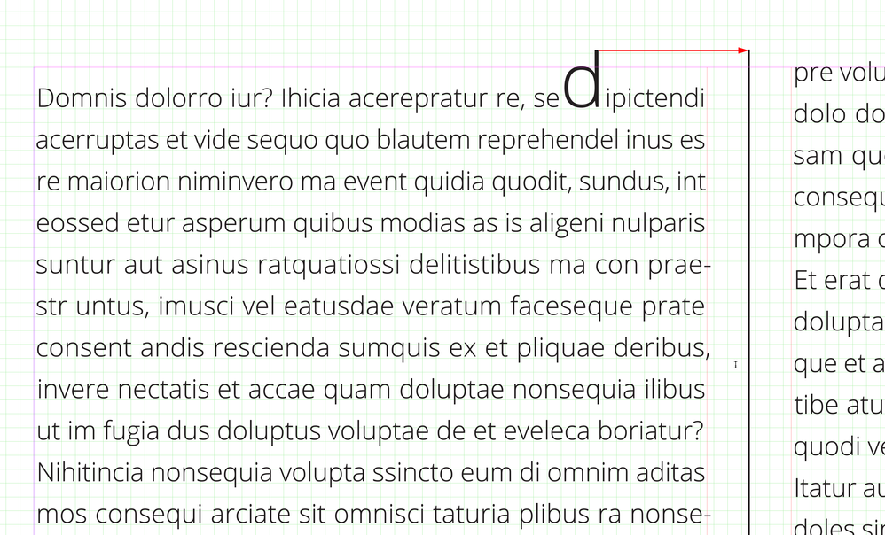

At the green arrows the offset is forcing the ruler to end at the boundary of the text.
But otherwise I have no idea why are rulers exceeding text boundaries.

Hi @Chris P. Bacon ,
hm, I thought, I gave the answer already somewhere else in one of your threads.
The starting point of the ruler is tied to the first character in your text frame.
Example:
That's a conceptual flaw in the feature.

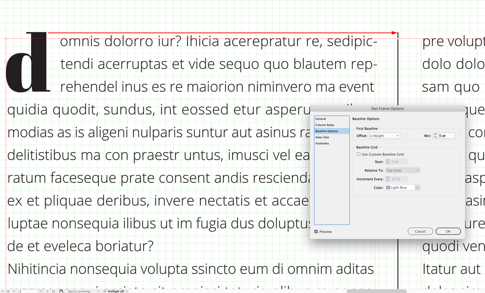

the sample in the upper right of my screenshot has no dropcaps at all.
Just a character with a different point site and some baseline shift applied.
So to work around the issue you have to isolate your first character in a different text frame and thread it to the main text frame. With text wrap applied.

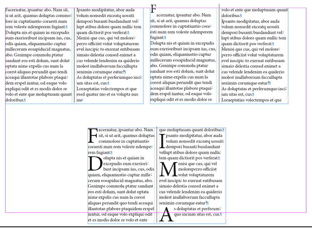

Hi Uwe, If I check the info button next to Column Rules in Text Frame Options it reads Runs from Ascent of the first line to the Descent of the last line of the text frame.
When there is a drop cap, it looks to me like the Column Rules start at the Ascent line of the drop cap character—the ascent line is defined by the type designer and may or may not be set exactly on the font’s ascender.
When there’s no drop cap it looks like the highest ascent line in the first line is used, but again fonts’ ascent lines can vary relative to the ascender:
Looks like Chris’s other problem isn’t related to the Column Rule Start—he has a text frame that is wrapping, so the text frame (not its text) determines where the rule breaks.
