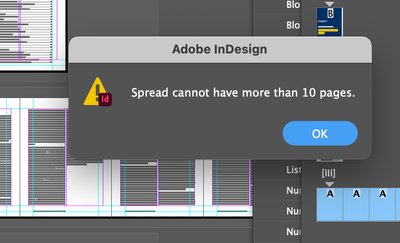

Community Beginner ,
Mar 20, 2024 Mar 20, 2024
I've realized that my design file is corrupt, hindering me from making significant changes without experiencing crashes. Despite this, I've already invested considerable effort into this file and need to implement a major alteration. However, due to the instability I'm unable to utilize its autoflow  feature effectively. The issue does not persist in the new file, but the styling is not there if I copy and paste it in to a new file.
Is there a method to transfer my existing design file into a new one while retaining all the styling attributes intact? I've tried converting it from a design file to DML format and then back again, even renaming it, but it does not help. Any suggestions on how to proceed? My goal is to establish a primary parent layout for smoother operation.
This is what is does when I try to flow text in to the primary parent any ideas why facing pages is turned off
You have corrupt content that is trying to force an invalid layout. See immediately prior answer.
Have you exported it to IDML, then opened and resaved under a new name as INDD again? That fixes nearly all InDesign file corruption problems.
The only other method is to create a blank new file (page size, margins, primary text flow, etc.) and do a wholesale cut and paste — select the whole text flow content in A, copy, put the cursor in B, paste. That will move all content in the text flow, including any anchored items, and all styles that are in use for any part of the content.
It won't restore page and text-box level formatting. You will have to recreate those.
It will also copy any truly corrupted content in the flow, likely repeating the problem. You may want to select sections of the text — chapters, for example — and paste them one by one into separate documents, or into an interim doc for review and cleanup, then paste them into the new final doc.
