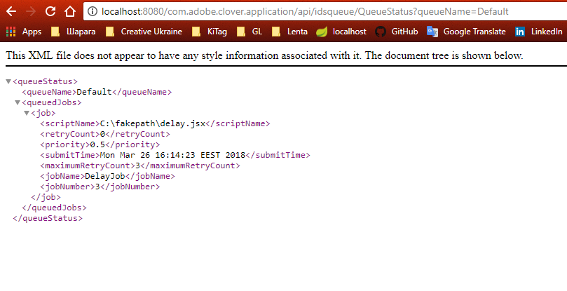

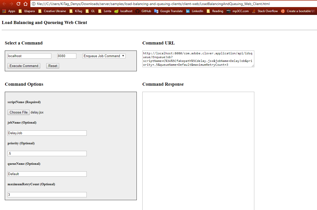

So I guess LBQ is running successfully. Then I'm trying to run a command "Enqueue Job" via web-client (by the way I didn't get any responds from any commands via web-client, I'm getting success responces only if I execute them directly via URL)
Below is the responce of QueueStatus command:

1) You're right, the web-client doesn't seem to work in Chrome and that could be down to the CORS policy (See image below).
You can either do what you did and use the web client as a URL kind of builder and manually paste it into the browser and wait for the XML response OR you can use it in Internet Explorer with the Java Addin Enabled (More on that on point 3 below).
2) With your "Enqueue Job command" I see you haven't edited out the "fakepath", now annoyingly the documentation doesn't mention this explicitly, you just had to spot it. Now if the web-client was working correctly the "fakepath" would be replaced if you clicked the "Choose File" and navigated towards the delay.jsx file. But, if you're using Chrome it'll have to be replaced manually and it has to be URL encoded. Here's an example of my URL with the "fakePath" removed and run in the browser.
http://localhost:8080/com.adobe.clover.application/api/idsqueue/EnqueueJob?scriptName=C%3A%5CServerV2%28Mar2018%29%5Cserver%5Csamples%5Cload-balancing-and-queuing-clients%5Csample-extendscripts%5Cdelay.jsx&jobName=&priority=.5&queueName=Default&maximumRetryCount=3
