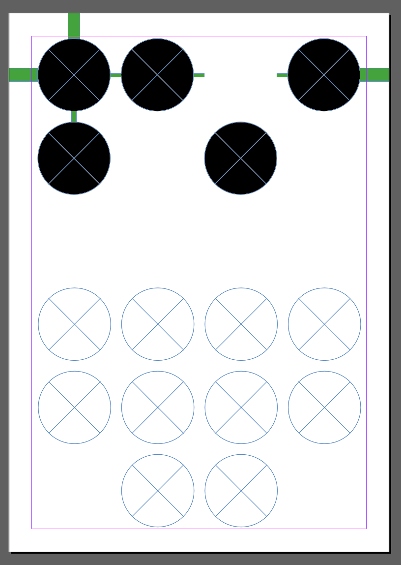

Hi all,

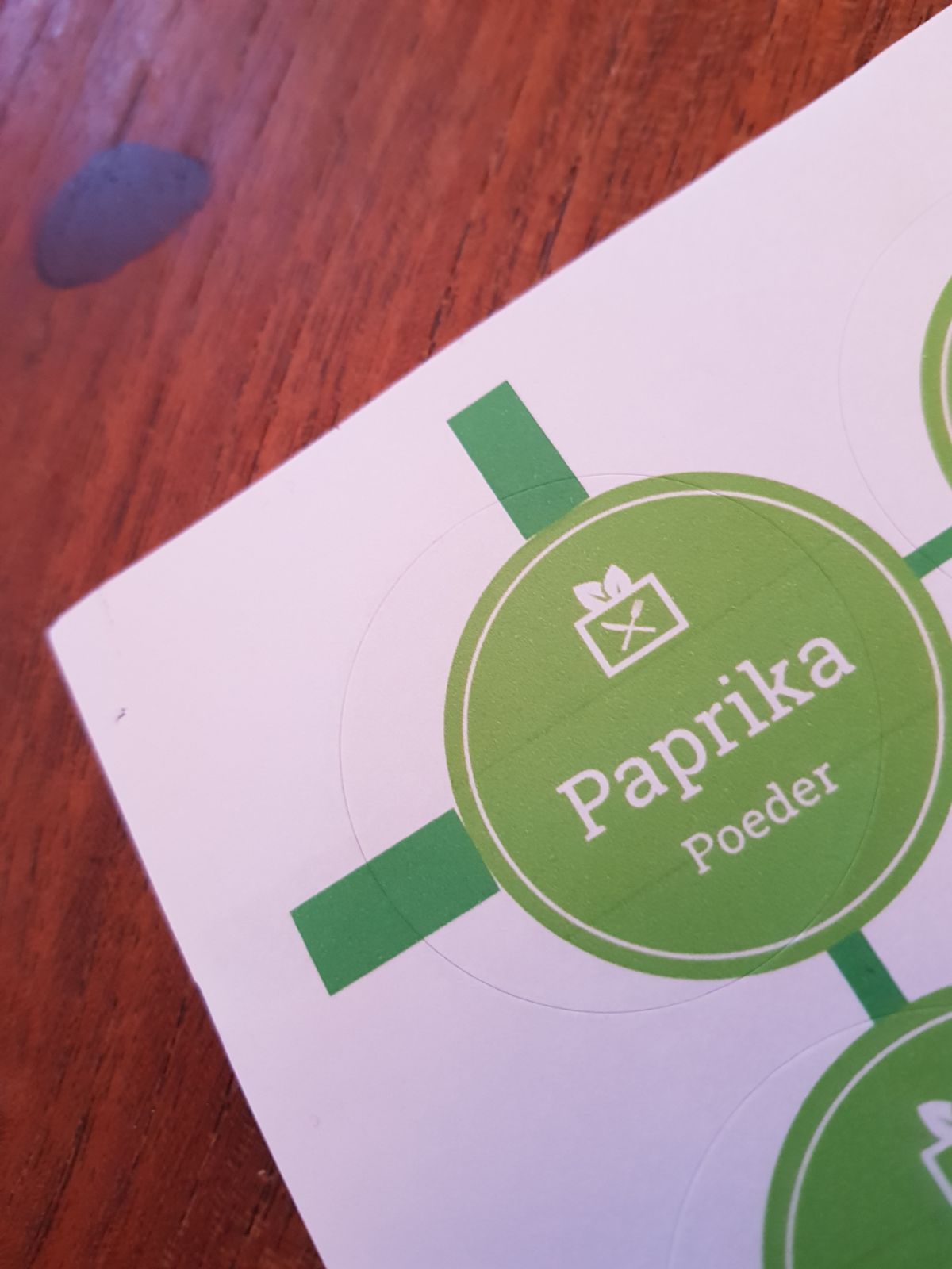

I am currently trying to print out out a sticker document that needs to be precise. There are 24 circles on the A4 paper, I used some green marks to see if the printer was even close to correct, which it's not because I can obviously see some white space when printed.
In my PDF I can see nothing wrong, so I'm not sure if it's my PDF or printer? I'm currently using an old printer but just for testing, I'm supposed to be using a Brother mfc-j5720dw but as I said I will be using it when I'm 100% sure it works as I'm testing right now.
Will be showing some images of my InDesign document, if it helps!
Woud love to hear if anyone knows how to fix this!Schermafbeelding 2017-08-18 om 19.33.19.png

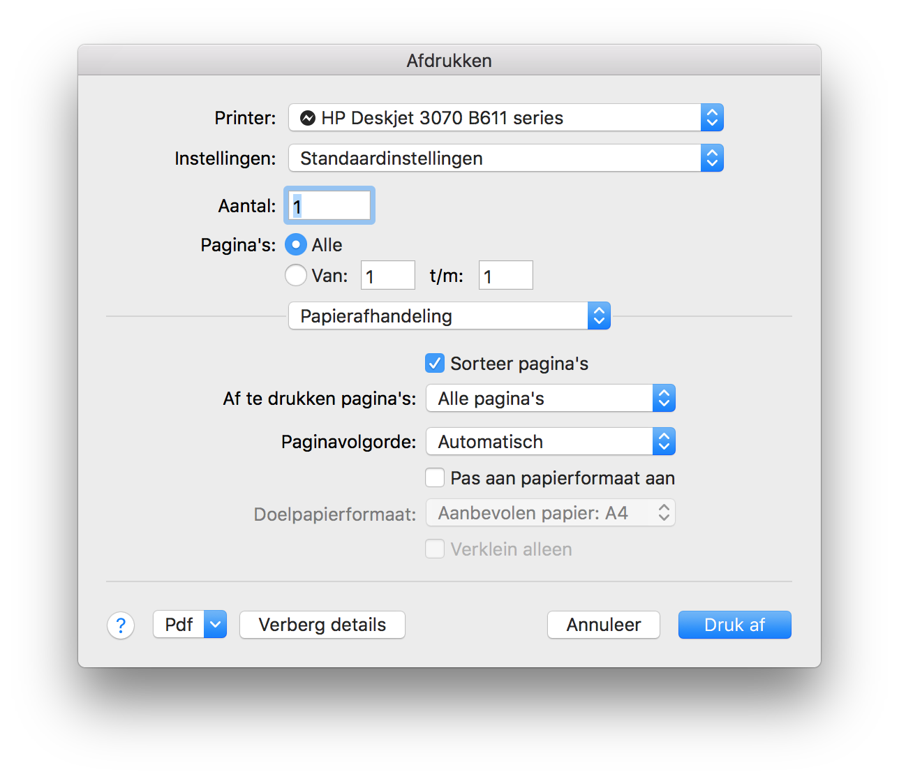

The print driver might also have a scale setting in the OS print dialog. Looking at your screen capture in #1, it looks like the art has been scaled relative to the paper die cut.
If you click Printer... is there a Paper Handling option with a Scale to Fit?

I think it's pretty much the same as yours
