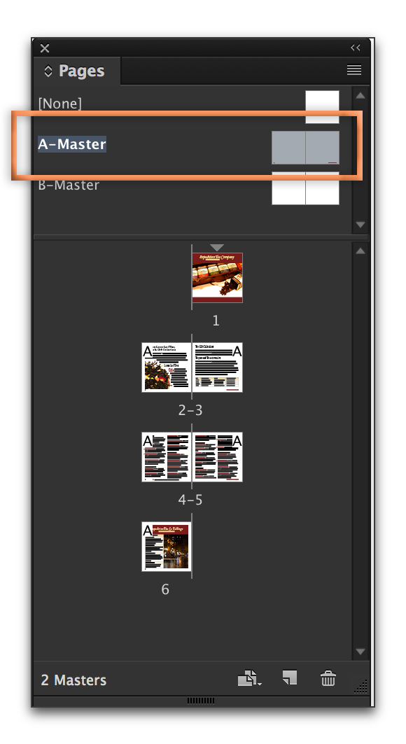

Since you have been doing this successfully for 17 months, could you be on the wrong master page? Or not fully on the one that you think you are on? That's my best guess. I prefer to use the Window > Pages panel to navigate to the master pages—but you have to double click on name A-Master to get there. A single click leaves you in Never-Never land.
If you look at the screen shot below, note that both the name A-Master and the thumbnails are selected.
