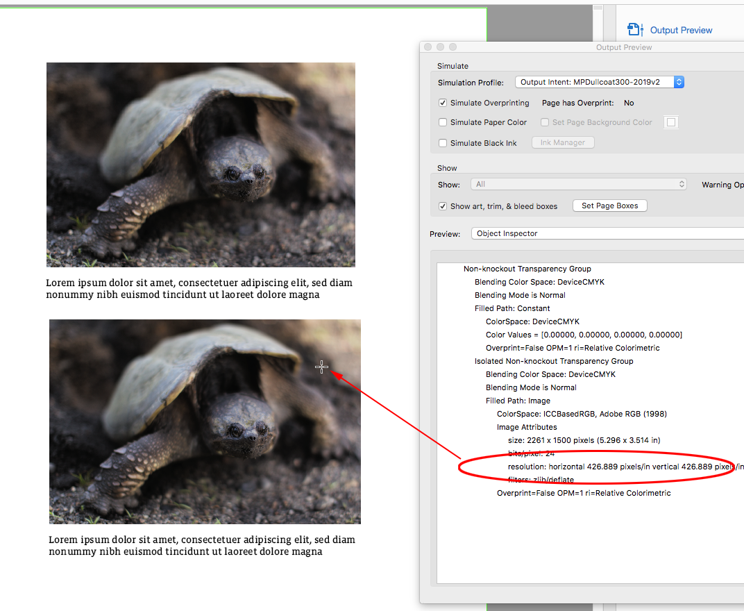

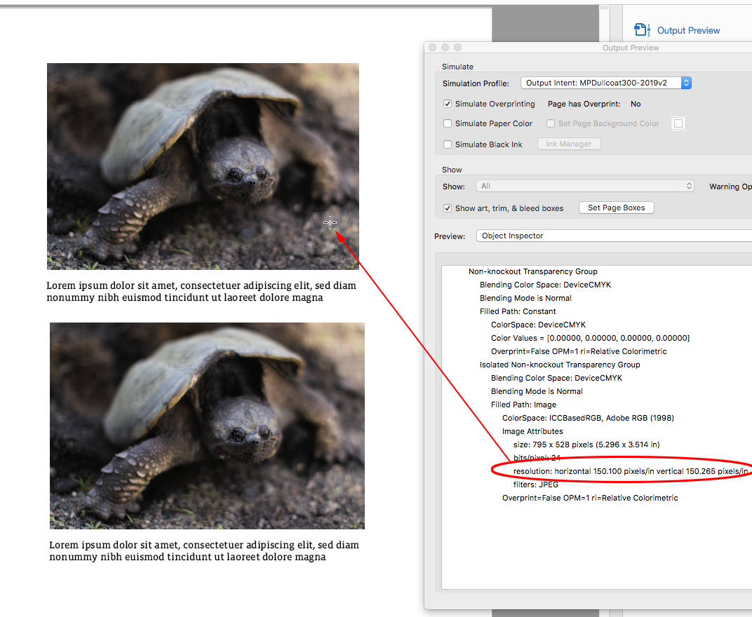

Jul 19, 2019 Jul 19, 2019
Sure. Here I’ve placed the same Illustrator file saved with the default PDF/X-4 preset—which allows compression and downsampling—and with the a default .AI save as.
In InDesign my Preflight Resolution threshold is set to 300ppi, and I've scaled both versions to 200%. Preflight picks up the PDF/X-4 as below 300ppi, which is expected because the default PDF/X-4 out of Illustrator sampled the image down to 300ppi, and then the 200% InDesign scale lowered the Effective res to 150ppi.
The AI version's Effective res also got reduced, but remained over 300ppi because the AI save left the Actual res of its placed image alone—it is 854ppi so its Effective res on the ID page is 426ppi.
The preflight error is confirmed when I export the InDesign page as PDF/X-4 with Downsampling turned off.
I think that it is fairly obvious that if you downsample to 300dpi when creating PDF from Illustrator and that you blow up the placed PDF to 200% in InDesign, that the “error” that you encounter in InDesign Preflight is to be expected. If you want/need PDF to be magnified when placed in InDesign, whether that PDF comes from Illustrator or any other application, you either don't downsample when creating that PDF or use downsampling that fits the parameters of your needs for repurposing.

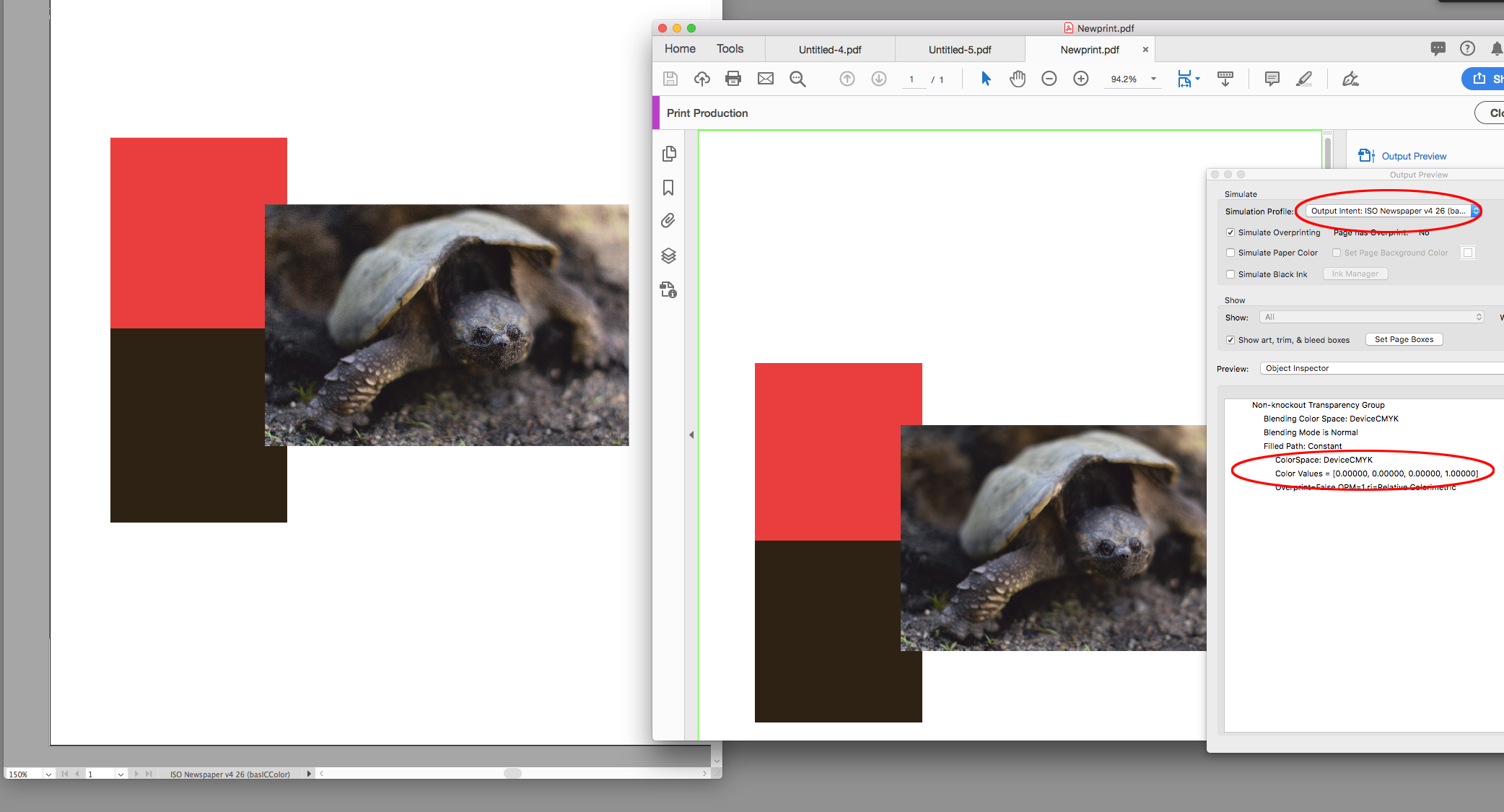

This seems to be yet another potential problem with a PDF/X-4 Save As out of Illustrator. You seem to be a color profile absolutist, and a PDF/X-4 saved out of illustrator is not going to assign a CMYK profile to the native InDesign fills and strokes when the document color mode is CMYK—document CMYK colors export as DeviceCMYK with PDF/X.
Not a problem in a disciplined workflow where one would be sure to avoid conflicting CMYK profiles and match up document CMYK assignments, but with PDF/X-4 you do have to watch out for document CMYK profile mismatches as well as image compression.
So this CMYK Illustrator file with a placed RGB image has a newprint CMYK profile assigned. If I export a PDF/X-4 and check one of the CMYK fills Acrobat tells me it is DeviceCMYK, while the RGB image has the correct profile assigned. The CMYK Output Intent is correct, but it will not be used when i place the PDF.
If I'm not paying attention to the ID assignment, and place the newsprint PDF/X in a GRACol Coated document, the intended color appearance changes—the CMYK values are unchanged because the PDF’s CMYK objects are DeviceCMYK:
