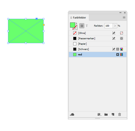

May 31, 2018 May 31, 2018
Below two screenshots that showing what will happen when using my second code snippet.
Before. Just spot color "red" in the document. I gave it a "green" look so that one can see the difference better when that has changed:
After running the snippet. Spot color "red" is mapped to the temp spot color. You will see the difference only if you turn on "Overprint Preview":
In this scenario you can easily remove spot color "tempRed" without problems.
Uwe
