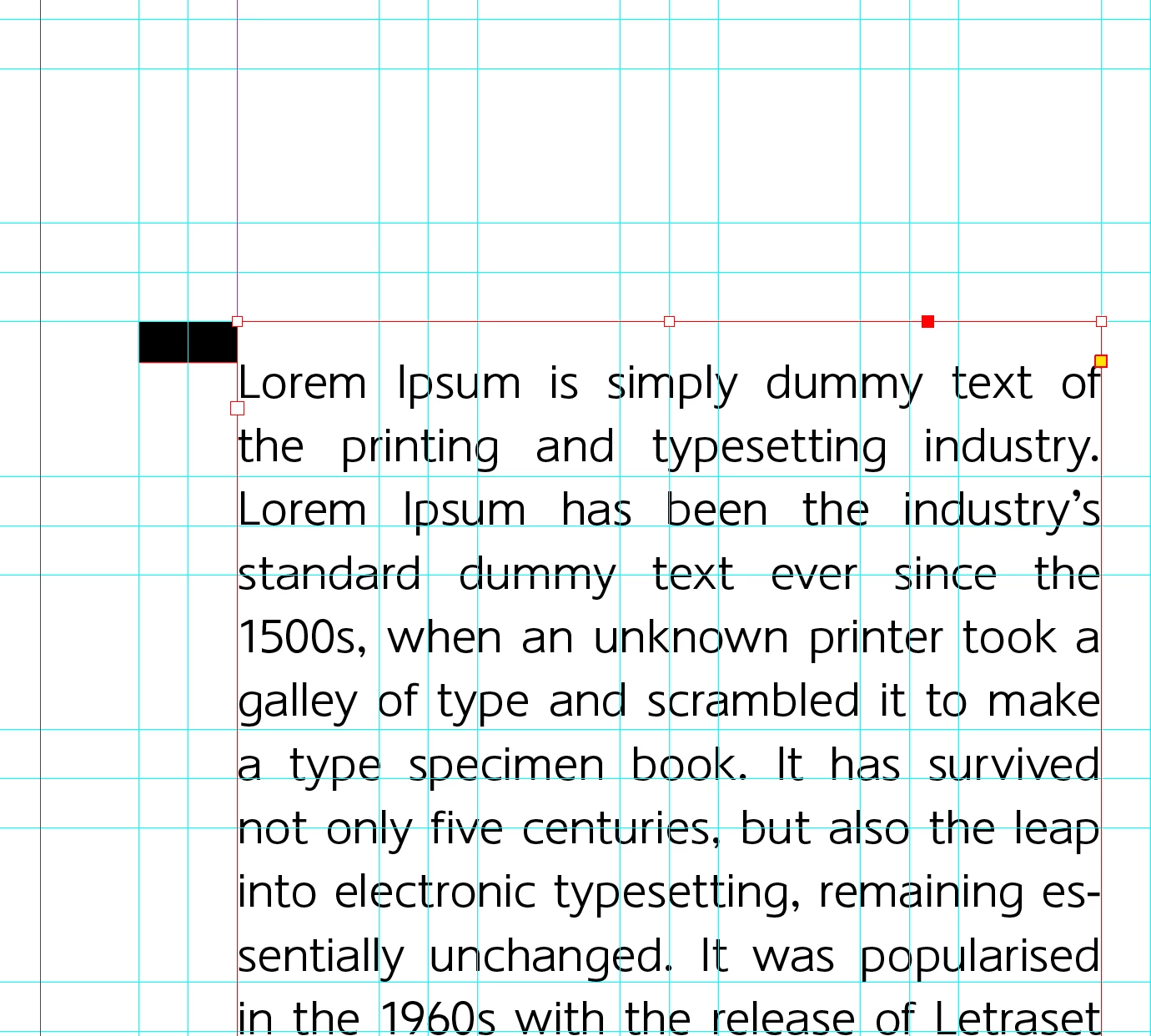

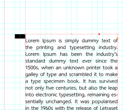

Dear all,
I'm using the font PSL Ornanong Pro (I think it's a default font in macOS?) for my paragraphs. Although I understand that each font has its own style, I want to know if there is a way I can decrease the space for the first line of the paragraph.
The screenshot shows that I placed the text box on my layout grid, and the first line is around 2.5mm away from the grid. Even after I changed the line spacing, it did not affect the first line in the text box. So I want to know if there is a way to make the text spacing fit with the grid layout. Or I can only manually adjust all the text boxes in my document? (I want to avoid manual adjustment cause the document is going to be more than 100 pages long (perhaps close to 200 pages).
Thank you.
Sincerely,
Karen

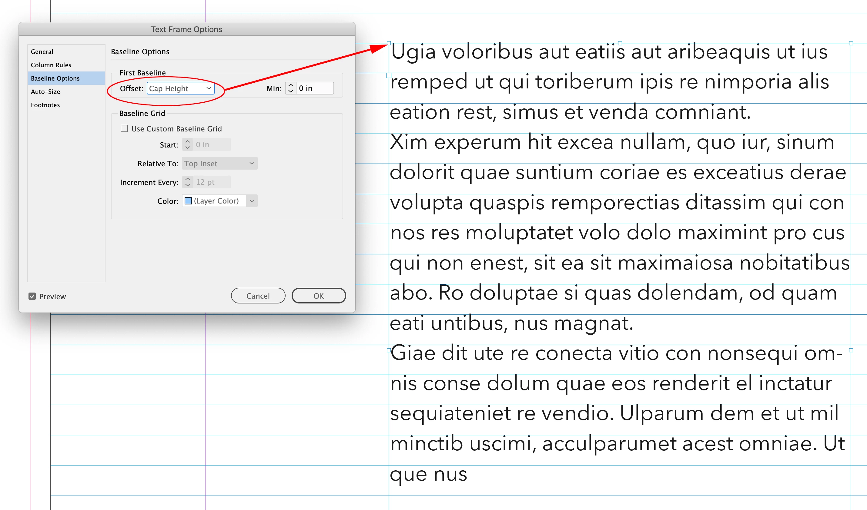

Correct answer rob day

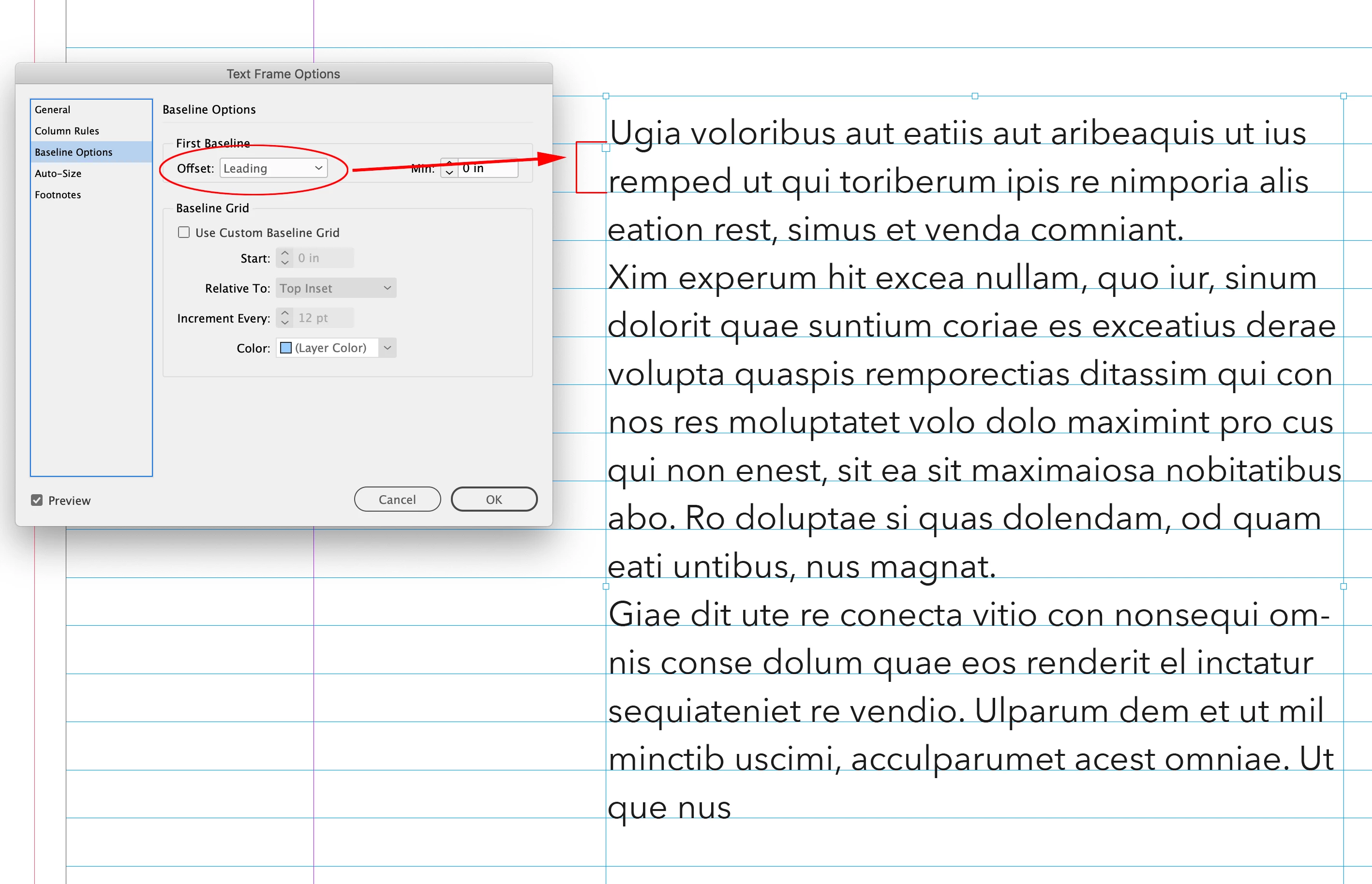

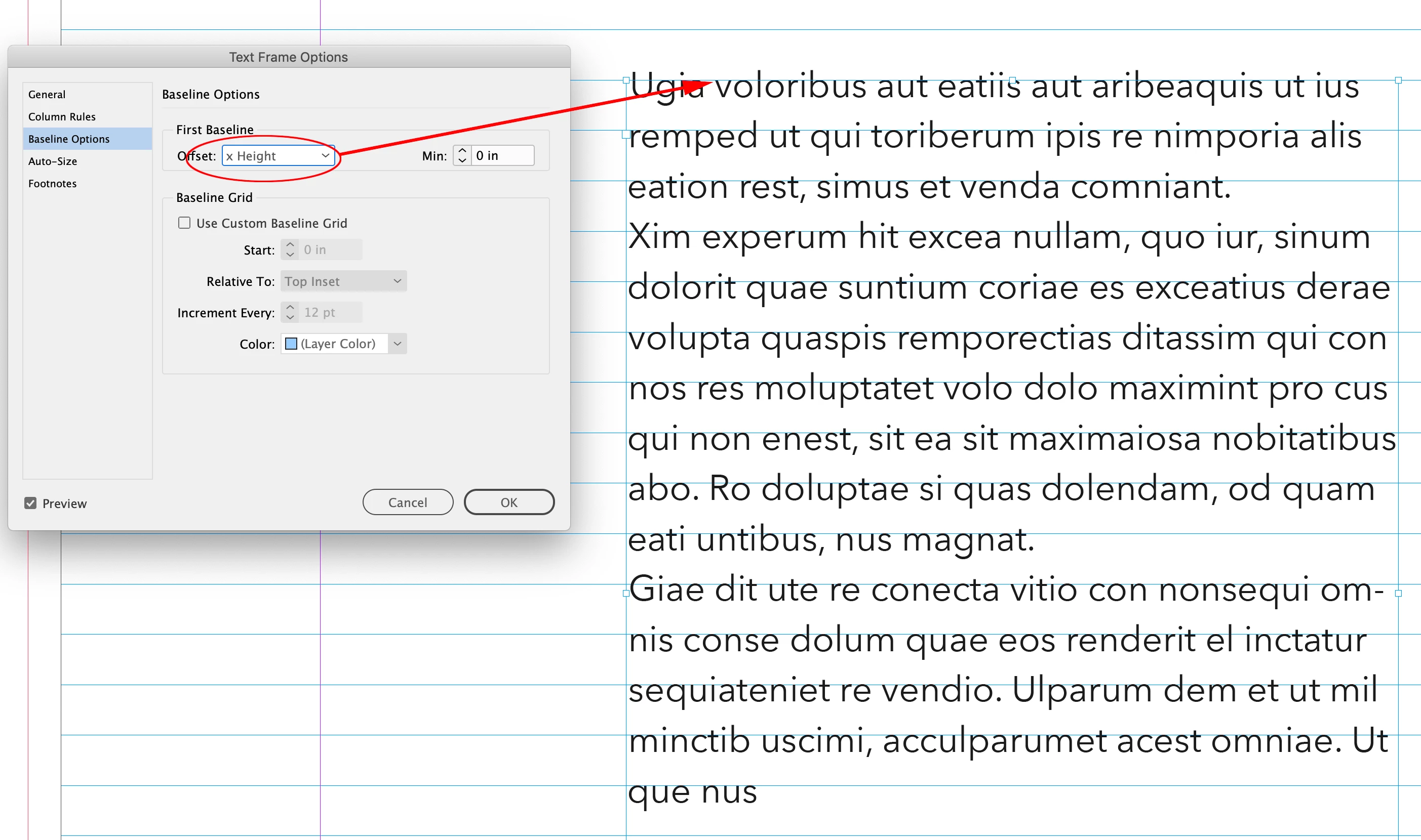

Hi @Karen JR , The Text Frame Options’ Baseline Options First Baseline Offset determines where the first baseline starts relative to the text frame. If I set it to Cap Height the first line’s caps align with the top of the text frame:
With x-Height the first line’s lowercase align with the top of the frame
Looks like you might have Leading set as the Offset—my text’s Leading is 14 pt, so the baseline of the first line is set at 14pts below the top of the frame:

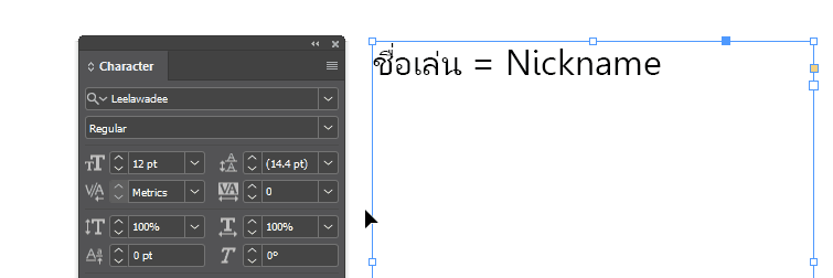

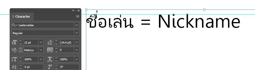

PSL Ornanong Pro doesn't ship with Mac OS, but you can install it from Apple servers using Font Book. I don't have a Mac right now, but Ornanong is a pretty Thai-sounding name (and a search for "Ornanong" only gets you pictures of Thai  folks), and so I'm willing to bet a fair bit that PSL Ornanong Pro is a Thai font.
I suspect that'd explain why its position in the text frame is so odd; if you whack Command + B for the Text Frame Options and look at the Baseline Options, it has some choices in the Offset dropdown that allow you to determine the distance between the top of the frame and the first baseline. The tallest possible Thai compound letters are much taller than a Latin-script capital letter, so using the Ascent value or the Leading value will often lead to this kind of gap.
It all depends on how the type designer chose to make room for all of that height: some will set the Ascent value to cap height, others will use the cap height plus a single diacritical mark, which of course won't work in languages like Thai or Lao or Vietnamese, which will often have tone marks on top of diacritical marks, as in the sample above.
... and sometimes the type designer's Microsoft boss will say "No, you can't have that much room for Thai in the OS, we need a more squished-down font" which is why so many of your -complex-script support fonts on a Windows box have two variants, one being a UI variant:
Anyhow, I think that's why you have that gap, and you could resolve it by picking a different Offset value in the Baseline Options.

Hi @rob day
This is a fantastic explanation! I think it was the baseline issue as when I changed to Cap Height, the new text frame made the text align with the top of the frame.
Unfortunately, the text frame that I made before I changed the setting didn't change accordingly, so I have to manually re-enter those. (But I'm just starting the document so it is fixable manually!!)

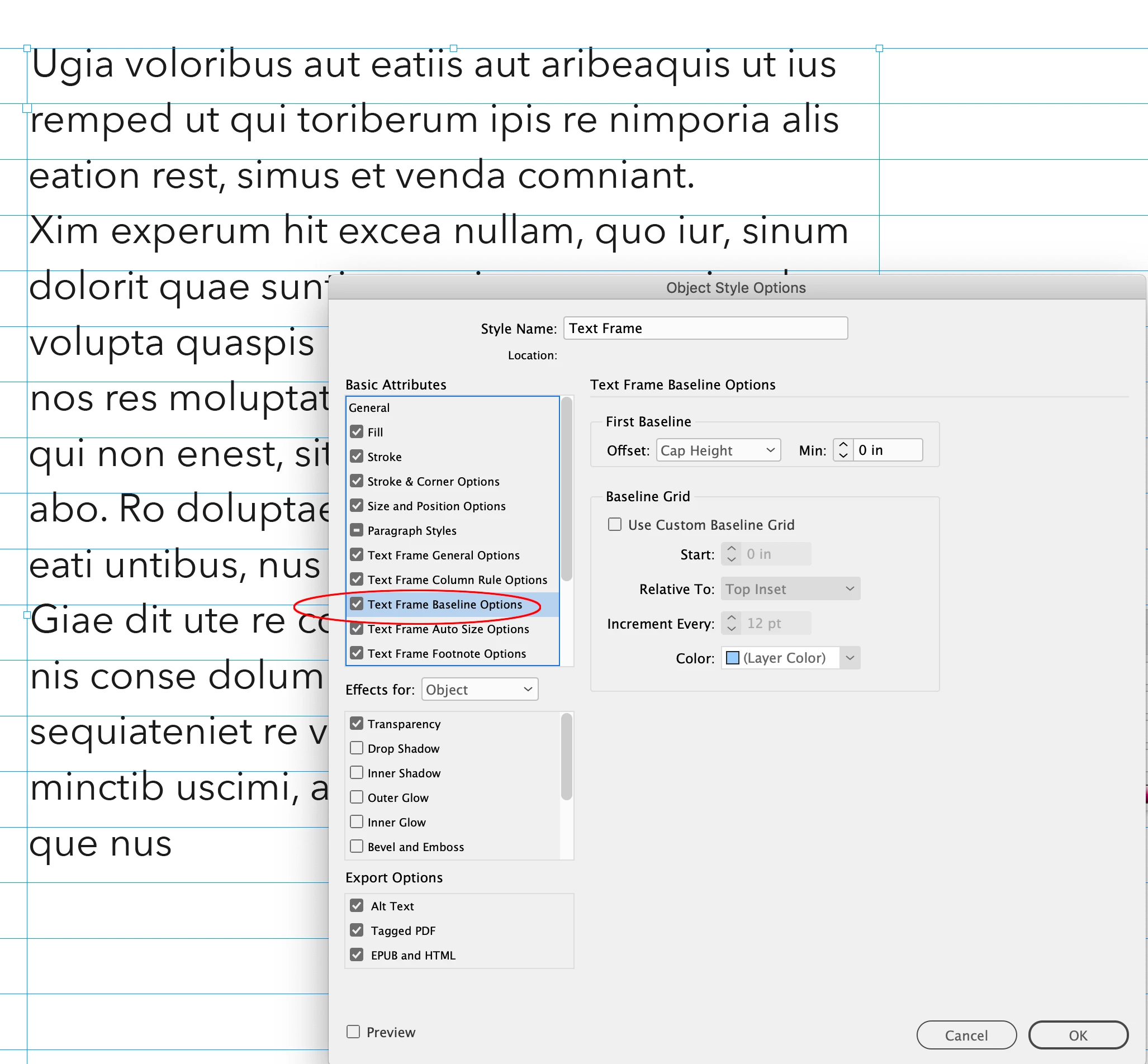

rob day
October 22, 2023
Baseline Options can be included in an Object Style:
