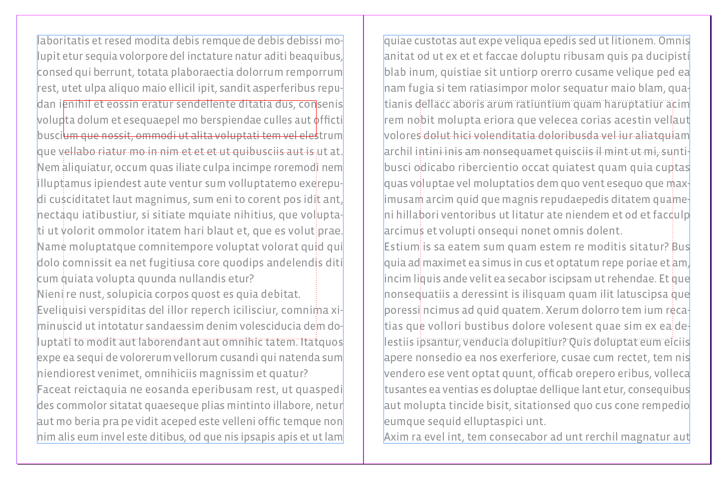

A primary text frame is automatically release on the live pages and has its own icon with an arrow.  Here the primary text frame is indicated by its icon when it is selected and there are also MP items indicated by the dotted frame outlines. A released MP item has a solid outline.
You might find this thread on primary frames useful:
Re: Can someone help demystify how primary text frames actually work?
Is there anything I can do without reformatting the entire project?

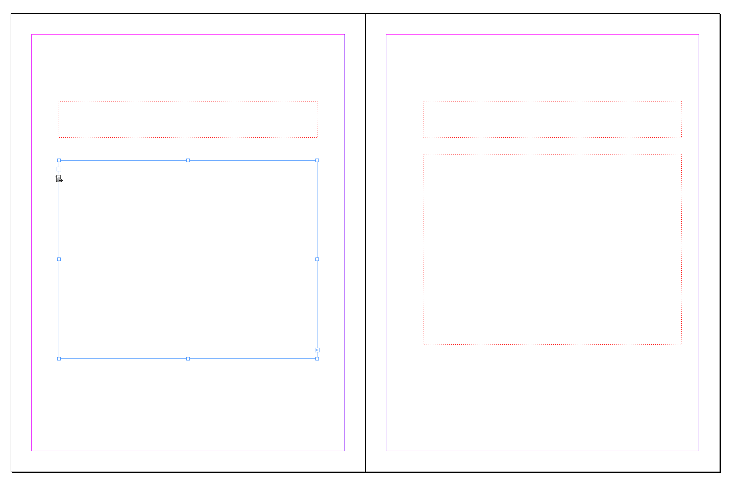

If your text is consistently in the primary frame you should be able to move it and delete the unused text frame on the masters:
So my primary textflow filled with text:
On the master page, the left page's primary frame resized and the unused MP item deleted
The updated page:
