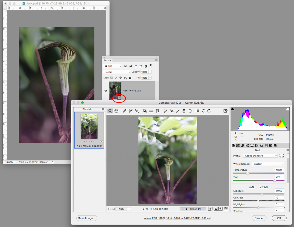

Also, RAW files can be placed as a Smart Object layer in a Photoshop file, so if you want all of your color corrections to be applied via ACR, you could consider a placed smart object work flow. Start with a Photoshop file at the desired dimensions, resolution, and color mode. Place your RAW file via File>Placed Link. The placed RAW file will have a link symbol in the Layers panel:
To make an adjustment to the ACR settings double-click the link icon and the ACR dialog will open:

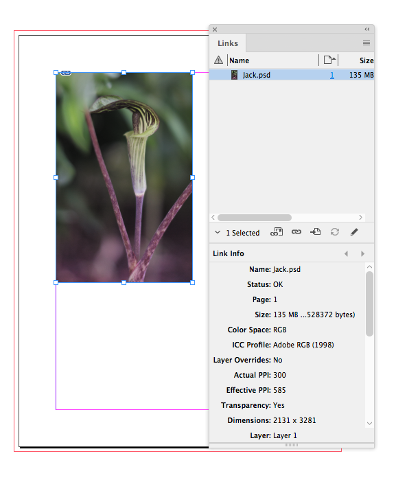

Save as a .PSD file and place in InDesign:
