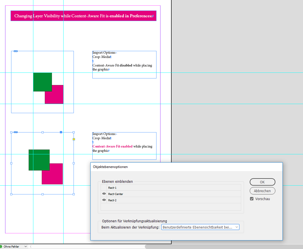

Here my results in screenshots:
Have an AI file with 3 layers:
Rect-1
Rect-Center
Rect-2
With all the layers just one rectangle is placed.
All 3 rectangles are not leaving the artboard in Illustrator.
Media is a different area vs Select All.
I placed the same graphic with Crop: Media on a page two times.
Difference: With the one on top, Content-Aware Fit in the Preferences was disabled.
With the one on the bottom Content-Aware Fit was enabled:
Duplicated the page two times.
On the left I changed layer visibility of the placed graphics while Content-Aware Fit was disabled.
No big surprise. The graphics did not "move" inside their frames.
On the bottom right page you see something different.
The graphic on the bottom changed in scale and position after I changed layer visibility.
Uwe

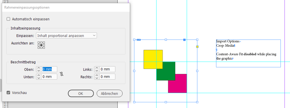

I'm very glad you asked this question.
The results I see with graphics from Illustrator and PDFs are not the same compared to images that are purely pixel based.
If I inspect the two placed graphics of my sample on page one I hardly can see the difference. But there is one:
Placed when Content-Aware Fit was disabled:
Placed when Content-Aware Fit was enabled:
No difference yet, but here it comes:
vs.
and that:
vs.
I wonder why the algorithm of Content-Aware Fit strikes again when changing Layer Visibility on the one graphic that was placed while Content-Aware Fit was enabled in the Preferences and does nothing on the graphic above when changing Layer Visibility. The Frame Fiiting Options are basically the same. Somehow the frame at the bottom remembers that it was placed while Content-Aware Fit was turned on in Preferences.
I suspect a bug here or a unknown property that was set to the frame or the image.
Looked for it in exported IDMS files but found none.
Uwe
Copy link to clipboard
Copied
Hi Uwe,
I suspect it's a bug, though it feels more like something needs to be "added" to the code rather than something "breaking".
I created an image like yours; I couldn't figure out what it was using to judge how to crop a square image (bitmap) vs. a square vector of the same thing, as it was enlarging the bitmap by about 20% and anchoring it in the lower right.
Copied
think, I found the reason for the different behavior. I did not look close enough:
I was wrong in my last reply, the Frame Fitting Options were basically not the same.
The frame where size and position of the contents did not change after changing the Layer View has:
Frame Fitting Options, Fit: "Fit Frame Proportionally" applied to.
Don't ask me why. The default with my InDesign CC 2019 with no document open is Fit: "None".
The frame where size and position of the contents changed has:
Frame Fitting Options, Fit: "None" applied to.
Still, something is very strange with that.
Uwe
