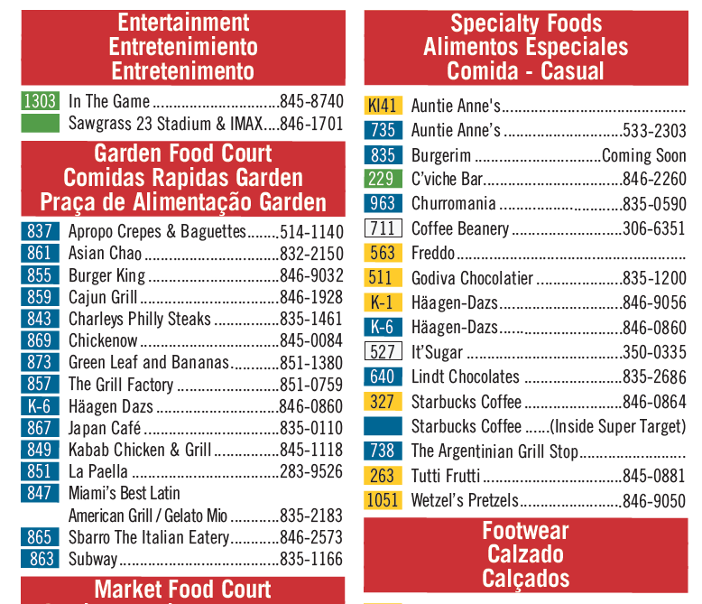

  • HI Trying to create paragraph with color tabs and description. Like the one you see on Maps for Malls showing stores/ store numbers and names. Like the sample below.
    Correct answer Laubender
    There is a color code. But not in order. NO excel
    I have an old quarkxpress file with all stylesheets but thinking on recreate this in indesign for future use. We make changes every two months .

    My question is how to create/add the color blocks to the paragraph?

    Thanks so much. I got it to work almost perfect. Still working on the black border (this is a little confusing but we’ll figure it out)

    One of the things I love to do in my spare time (for which I set aside a couple hours a day as it beats watching TV), is to try and solve such problems. So thank you for posting the issue, Manuel!
    I don't have a current subscription, so I used something else. I didn't add tab leaders in my text styles on purpose.
    My take on this is if I had this job to do every couple months—is there that much turn-over, or is it a low print-run, or?—and the budget was low, I would update a spreadsheet, copy the sheet, paste into a text editor and use Em Software's data merge. Once set up, it takes a minute to produce, maybe a couple minutes to handle bad frame flow, etc.
    But if there was a decent budget, I would likely use a database for error checking upon entry/changes, and then export tagged text and, again using an Em Software product to import, just import the text into my template.
    However, like mentioned above, how I would handle the output would partially depend on what is given me.
