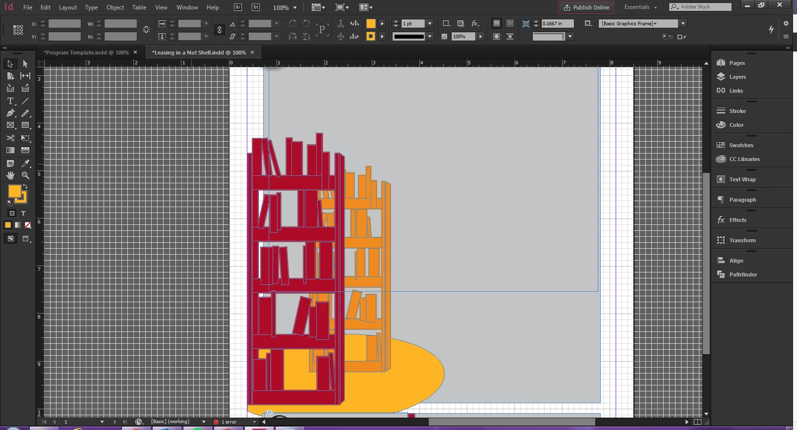

I created these two bookshelves using the rectangle tool in InDesign, I like how they turned out, but there is one problem. They have no clipping path options. I need InDesign to set/ activate/ recognize... whatever... a clipping path for this whole shape so that I can set a text wrap around it, and create a cast shadow for it, but I don't know how to get it to show up.

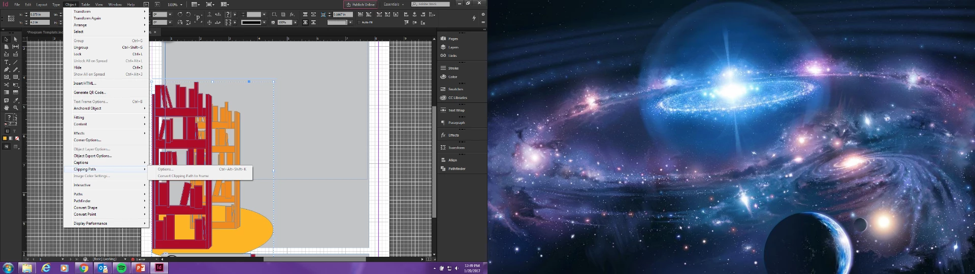

As you can see above, all of the clipping path options are grayed out. This is preventing me from being able to apply a text wrap to the shape rather than its bounding box, or creating a cast shadow. Sorry for the extra screen, I couldn't get a picture of the menu with just one screen because alt closes the menu lol. So how to I create or get InDesign to recognize a clipping path for this object?

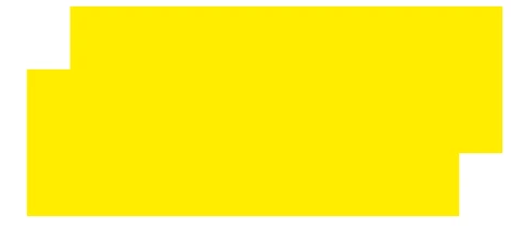

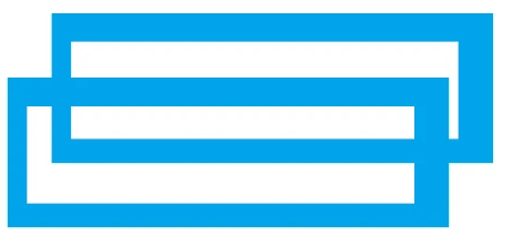

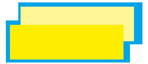

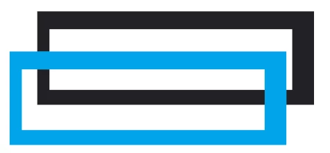

Make copies of both shelves. Combine each shelf to a single object.
Select both, combine.
If needed, patch the „holes”: put any figure(s) on top
Select all and Combine again:

Now, I think there is confusion on needing a clipping path. In InDesign, the Clipping Path dialog box is used for transparency. In text wrap, the clipping path option is used to access a clipping path coming from Photoshop as a way of handling text wrap. Same name, two very different applications.
To apply text wrap to a bounding box, you know to choose button #2.
To apply text wrap to the object shape, choose button #3. It will follow your shape automatically.
If you want to further tweak the wrap, use the Pen tool and Direction Selection tool and for instructions see "Change the shape of a text wrap":
Learn how to wrap text around objects in InDesign

While everything above, what Barb said, is absolutely true...
