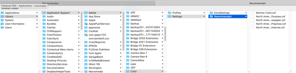

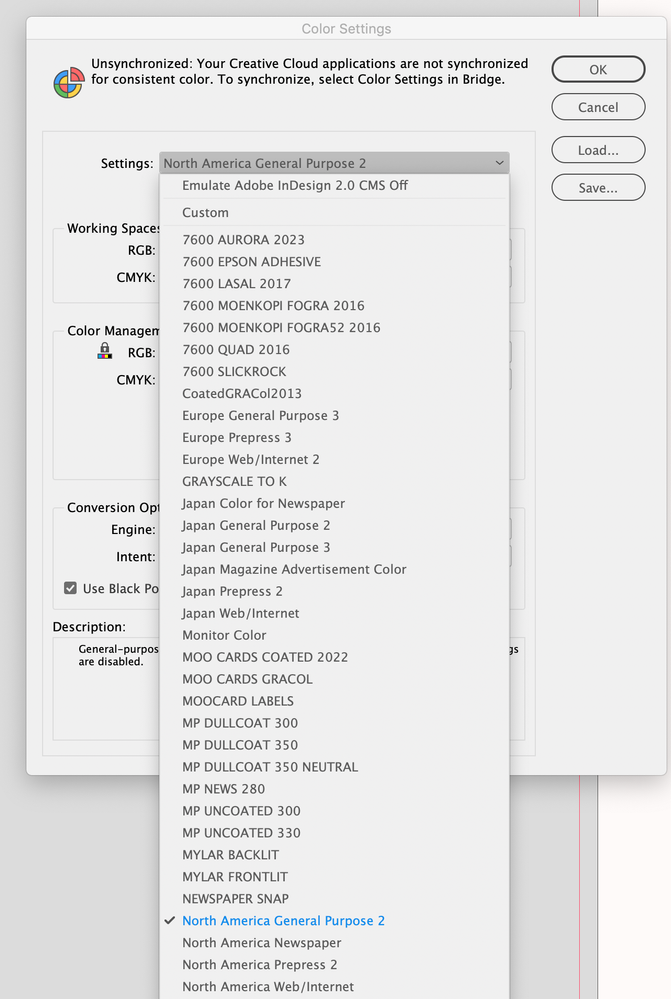

Hi @Alessandro34199326wwsx , just to clarify the Settings presets are not Color Profiles (.ICC files), they are .CSF files which are not saved in the same place as Color Profiles. Here is my Settings list:
On OSX the global .CSF files installed with the CC apps are located in:
‎⁨Startup ▸ ⁨Library⁩ ▸ ⁨Application Support⁩ ▸ ⁨Adobe⁩ ▸ ⁨Color⁩ ▸ ⁨Settings⁩:
My saved user settings on OSX are located in:
‎⁨Users⁩ ▸ username ▸ ⁨Library⁩ ▸ ⁨Application Support⁩ ▸ ⁨Adobe⁩ ▸ ⁨Color⁩ ▸ ⁨Settings⁩
So you could have all of the default .ICC profiles installed, but not have any of the default .CFS files installed
