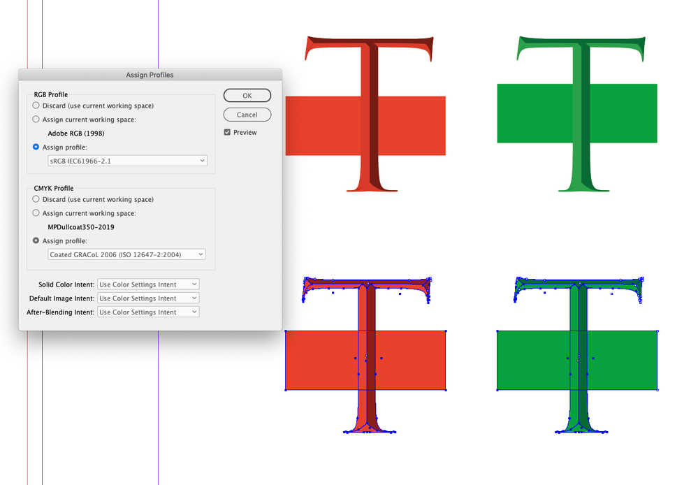

Here's one quick workaround. No need to use any scripting, this way.
The "solution" is to use the Edit > Convert to profile command.
And then, Export without (further) conversion to Acrobat.
The results were not perfect but much closer to the expected CMYK values.
For some reason, the objects don't show up under DeviceCMYK?
But do show up as DeviceCMYK under the Object Inspector...

Hi Rob,
I better take the time to document evertyhing with screen grabs. Until I do...
The DocumentRGB = sRGB
The DocumentCMYK - GRACoL2006_C1
So Export with NoConversion.
And when I open the exported PDF in Photoshop, the CMYK build remains the same?
Regards / Roger

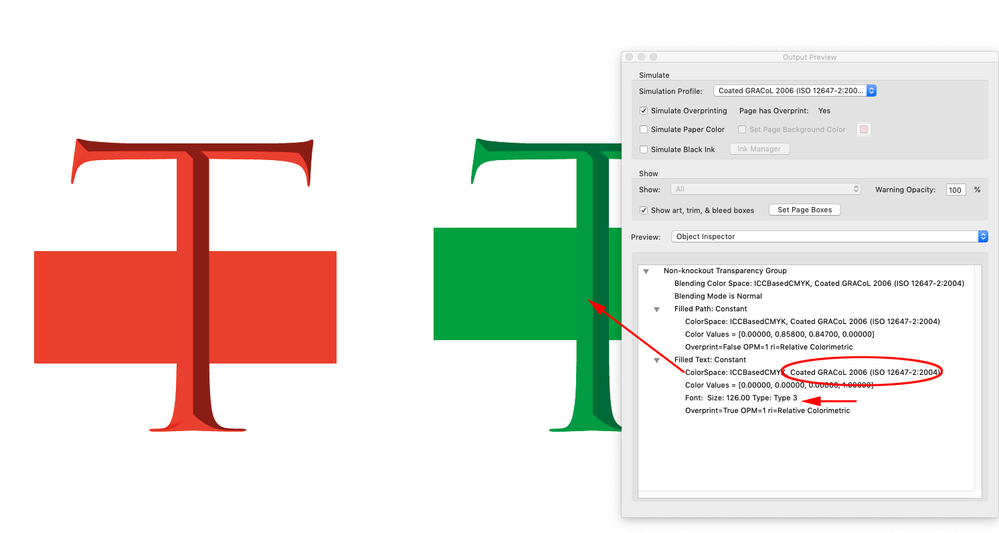

Jul 28, 2021 Jul 28, 2021
I’m not getting anything close to the InDesign CMYK values.
Here I’ve added some control fills that match the font color—again the bottom Ts have been converted to outline:
Export to PDF/X-4 with no conversion—the control fills match:
Opened into Photoshop as GRACol CMYK:

Here's what I'm finding this far. I opened up your document and Exported using the PDF/X4:2008 Preset.
In Acrobat, under Output Preview, the document elements only show up under RGB ICC, which makes sense.
BUT the top red T disappears...? What can I say.
In Photoshop, I notice the discrepancy between the stem of the two Ts, as you reported. No question.
For "curiosity"...
I pulled the Separations Preview in InDesign and, when I switch to CMYY in the Output Preview panel, I see the same thing as in Photoshop?
To me, the font Trojan RGB "color space" is most likely NOT sRGB, even though the officiel SVG specs says "sRGB".
The two sets of elements were clearly not processed the same way? Are not in the same "source" color space.
It's possible the default Flattening Color Blending Space setting, which is usually CMYK, is getting in the way?
I tried swittching to DocumentRGB space and immediately, the stem of the red T changed visually, no longer matching your solid RGB rectangle below.
I've iterated a few times and I'm surprised to find a difference in the "name" of your "red" swatch (r217g60b42) which is the correct value for the left hand side of the stem and the actual RGB values shown in the Color panel R=250, V=59, B=34.
Here's a screen capture : https://1drv.ms/u/s!AkD78CVR1NBql-Bp6rMydhiwmdwQtQ?e=ULWHfr

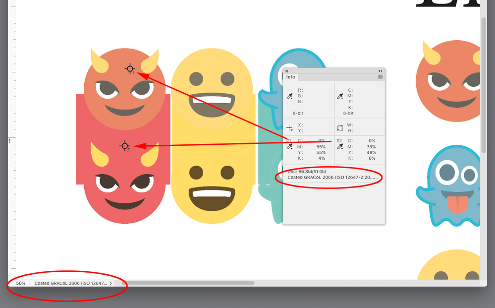

My latest experiment, based on EmojiOne "color font" selected glyphs, has gotten me the correct output in both Acrobat and Photoshop.
I invite you to take a look at my InDesign document and exported PDF/X4 here : https://1drv.ms/u/s!AkD78CVR1NBql-Bql5V3UhukEC8GPQ?e=axtsHz
/ Roger

Jul 29, 2021 Jul 29, 2021
Hi Roger, I think it’s important to note that the the problem is only showing in RIP’d output and is not really noticable in InDesign or an exported PDF— @DKingDesigner only caught the problem in the printer’s returned PDF, which was likely run through their RIP. I also am seeing the problem with your example when I imitate a RIP by opening the exported PDF as CMYK.
I think you have to use AcrobatPro’s Object Inspector (not Separation Preview) to see the unusual color properties of the SVG fonts. It looks like the ColorSpace and Color Values in Object Inspector depends on color applied to the selection in InDesign. So here I set the fill of the selected glyph to RGB black and it gets exported as ICCBasedRGB sRGB
The native Color Values for the outlined version are not the same:
The PDF converted to a GRACol CMYK bitmap:

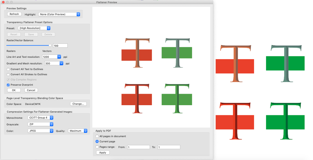

Hi Brad @ Roaring Mouse , it looks like the problem happens in the transparency flattening and isn’t related to profile inclusion. I do see better results with PDF/X-3 and PDF/X-1a where the page is flattened on Export (Acrobat 4 Compatiblity).
PDF/X-4 as well as X-3 and X-1a export Document CMYK color as Device CMYK. With PDF/X-4 it is a feature not a bug, it reduces the chance of accidental CMYK-to-CMYK conversions (i.e. [Black] converted to 4-color), and the Output Intent Profile tells the printer what the document CMYK profile is.
It looks like the SVG fonts incude transparency (InDesign’s Flattener Preview highlights Trajan Color) If I export my Trajan example as PDF/X-4 and flatten the page using AcrobatPro’s Flattener Preview the extreme color problem becomes apparent.
Ironically one of the selling points of PDF/4 is it delays flattening of live transparency and possibly color management until output, but with SVG fonts PDF/X-1a’s flattening will produce a better result.

I think that also indicates live transparency in the PDF is the culprit—distilled Postscript files get flattened.
If I print and distill my example, the PDF has no transparency, but there are also no fonts listed in the PDF—the Type 3 Trajan font gets converted to a DeviceCMYK image. Both a distilled PDF, and an export to default PDF/X-1a give me numbers that match InDesign’s Separation Preview—but in both cases the SVG Type 3 font is no longer listed in the PDF’s Document Properties.
If I set the PDF/X-1a preset’s Standard to None, change the Compatibility to Acrobat 7 (live transparency), and include the GRACol Destination profile, the PDF numbers no longer match InDesign’s Sep Preview, but the Type4 font is included in the PDF:
