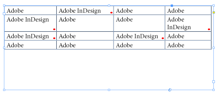

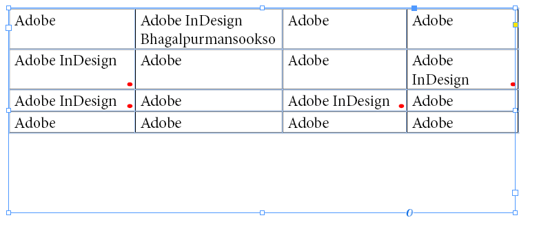

I am facing issue with column overflows return false, while cell overflows is working fine. Can anyone explain why?table-overflow.PNGtable-overflow-output.PNG
var doc = app.documents.item(0);
var tf = app.selection[0];
var tbl = tf.tables[0];
var i;
for(i=tbl.columns.length-1; i>=0; --i){
	var col = tbl.columns[i];
	while(col.overflows) {
		col.width++;
		doc.recompose();
Note: I do not want use cell.overflows because table has arournd 4000+ rows.

Ok, I did look into this a bit more and I stand corrected. It seems it returns true only if the first cell in the column is overset, no other cells state is being taken into consideration.

Based on my investigation I see that the column overflow returns true only if all the cells in the column are overflowing or are empty. As soon as any cell gets its overset resolved, the return is false and that is what must be happening with you.
-Manan
