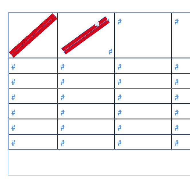

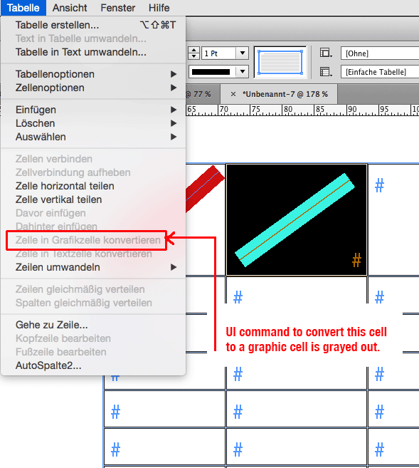

Feb 08, 2017 Feb 08, 2017
Here an example for a text cell you cannot convert to a graphic cell in the UI.
The contents is an anchored polygon with two path points:
The menu command to convert text cells to graphic cells is grayed out.
Cell is selected:
However, by scripting you could try to exactly do that.
Convert to graphic cell and "preserve data" ( if possible )
app.selection[0].convertCellType( CellTypeEnum.GRAPHIC_TYPE_CELL , true );
The result is an overflowing cell with cell type GRAPHIC_TYPE_CELL .
If I select the first insertion point of the next cell and use the left arrow key to go back I am encounter this very strange scenario.
A selected object in the graphic cell that is not showing in the UI despite the fact that its stroke weight is 8 Pt and the stroke color is red.
I bet, that's something the developers of graphic cells never had in mind but implicitly can be done by scripting.
Can we copy the cell if we selected it? No.
Error message in my German InDesign: "In Grafikzellen dürfen keine orthogonalen Linien enthalten sein".
"Graphic cells must not contain orthogonal graphic lines."
Can we copy the whole table? Yes.
Can we copy parts of the table? Yes, if this particular cell is not selected.
