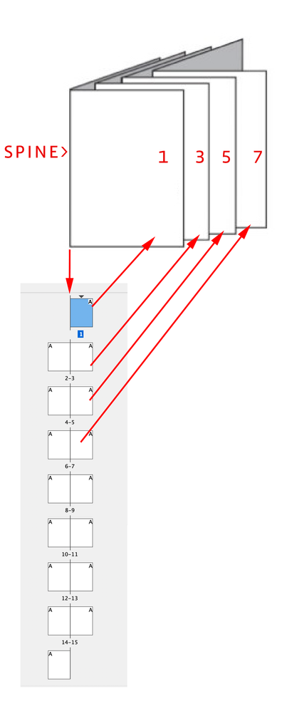

Hi @Brigit Ananya , Unless the binding method is wire-o where the inside edge is trimmed and visible, you don’t need an inside bleed—most binding methods fold the inside edge on the spine mark, and any bleed area would have to be removed when the printer imposes the pages into printer spreads:

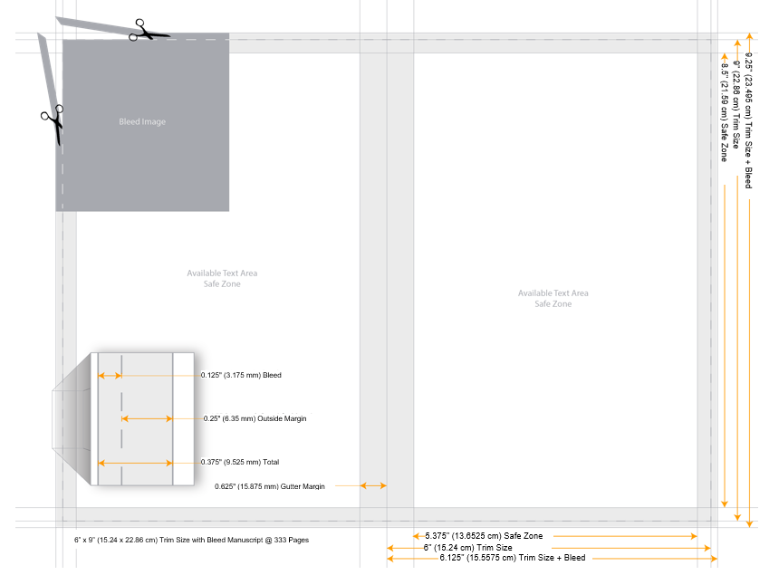

I think amazon only offers saddle stitch and perfect binding, neither needs an inside bleed. Their bleed guide shows outside, top, and bottom bleeds:
https://kdp.amazon.com/en_US/help/topic/GVBQ3CMEQW3W2VL6#bleed

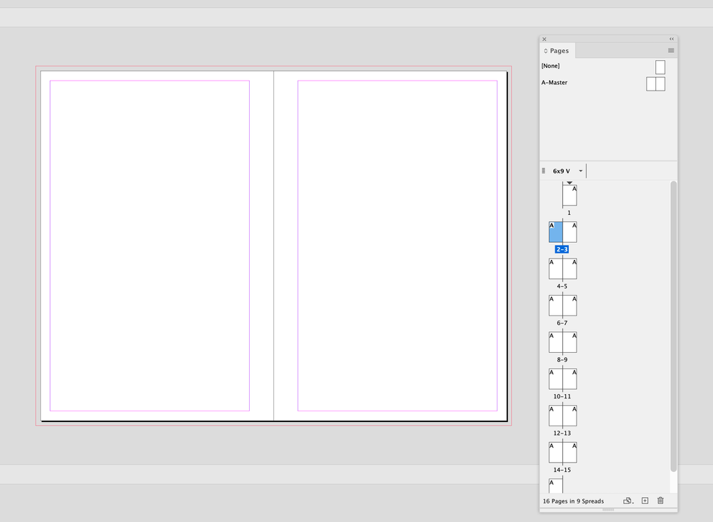

The InDesign Document Setup for the layout guide shown in the link would be this:
