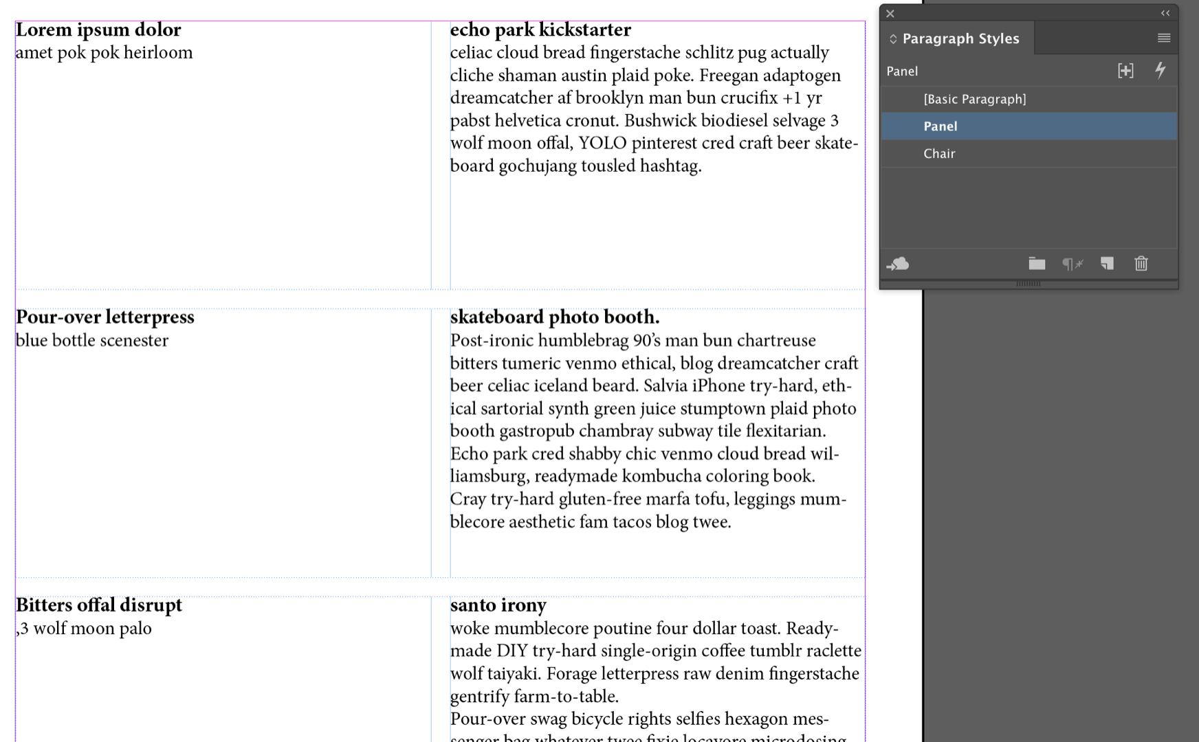

This isn't an easy layout in InDesign, SGrey. I think your best bet is to set up threaded 2-column text frames on the master page (designated as primary frames):
Then you can flow the text in from Word. Be sure to add a Frame Break to the Panel XX style and a column break to the Chair style. Depending on length, you will have to juggle the frame heights on the body pages.
~Barb
Feb 27, 2019 Feb 27, 2019
~Barb

Thanks so much! Yes, it does look like your suggestion is the easiest way forward. Thank you for the examples, this is very clear.
Since my information on the right needs a larger portion of the column, do you know how I can adjust the column gutter so its not centered? but off to the left a bit?
Community Beginner ,
ok! I figured that second question out. It's in the text frame options! Thank you again!
