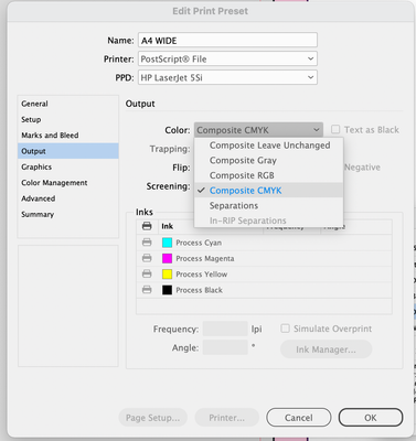

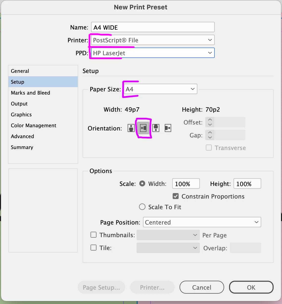

So, in InDesign, create a print setup (File Print Setup > Define) and create one for your A4 size, like so:
Select Postscript File, then any possible PPDs will now be listed. Choose your HP PS printer. Also, make sure to select a landscape orientation as appropriate. (If you had the Adobe PDF 9.0, you would select that PPD instead).

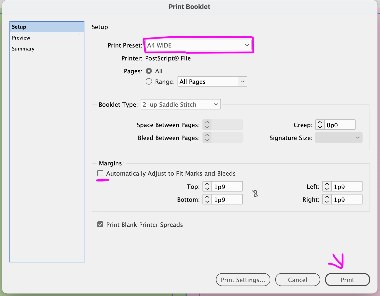

NOW, print your Booklet, selecting the Print Preset you just defined, and make your PS file. Distill that and you should be good! The only issue your end user will have to deal with is defining how to print the double-sided, as it will require selecting short edge binding to keep the pages the right direction.
